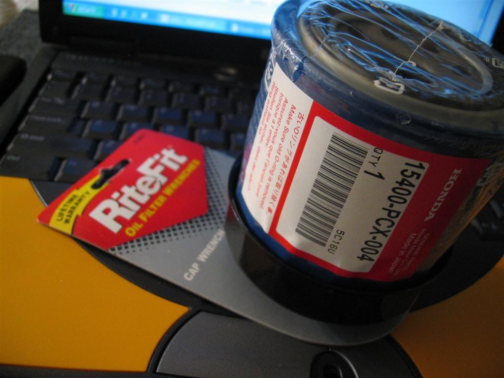

I just bought an oil filter wrench... $3.99 at Pep Boys - MUCH cheaper than the $25 Honda charges for the same thing...
It's a "RiteFit" cap wrench, model # A257. The catalog at the store specifically lists this one for the PCX filter. Here's a pdf of that:
http://www.ctatools.com/catalogs/ritefit_appguide.pdf
I just tried it on an OEM filter, and it fits perfectly! Pretty good for $4
Any 80mm x 15 flute wrench should fit:
http://www.amazon.com/Lisle-LIS54720-Filte...s/dp/B000FLUBAS
