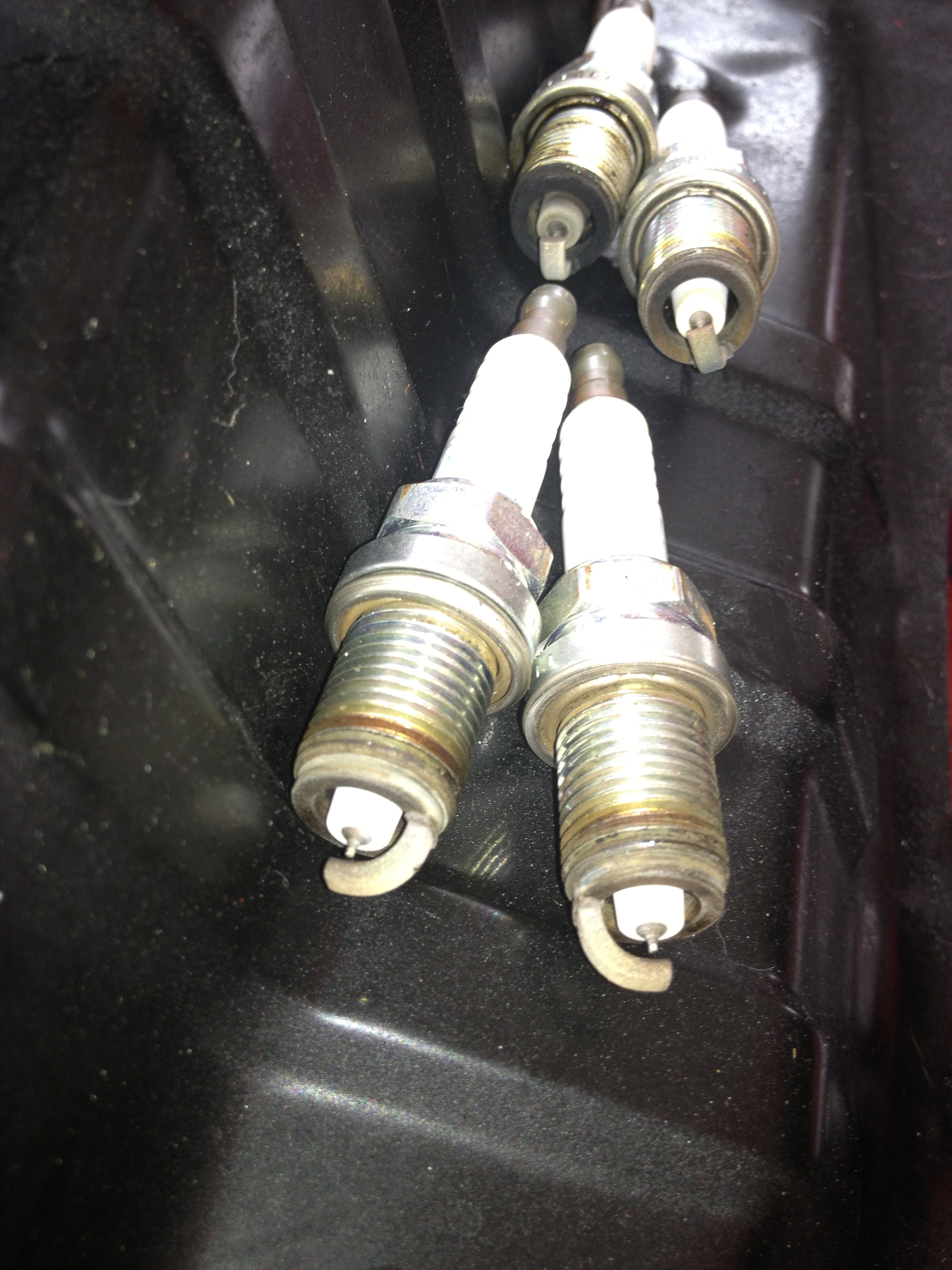

Battery is new so no problem there with cranking power. I took car to local recomended shop today. Only code showing today was p0172. Rich condition. Here's what the plugs look like. Obvious which one is cylinder 4. Car is running smooth and seems fine again, so it makes me think bad o2 sensor. I am guessing so any input i aprieciate.
Really worried that i have a broke ring on cyl 4 though.

redo compression test, add a cap of oil to cylinder 4, if the compression goes up your rings are bad. the black plug could also be a bad tube seal so check that too while you are at it.
you can buy your own compression tester from HF for under $25

there are 4 spark plug tube seals under the valve cover that can get ripped and allow oil into the spark plug dwell. this causing your misfires is unlikely though.

I added about 20cc 10-30 to cyl 4 and the compression jumped from 205 to 300 psi! My guess is p0172, rich condition, is unburn gas's.
