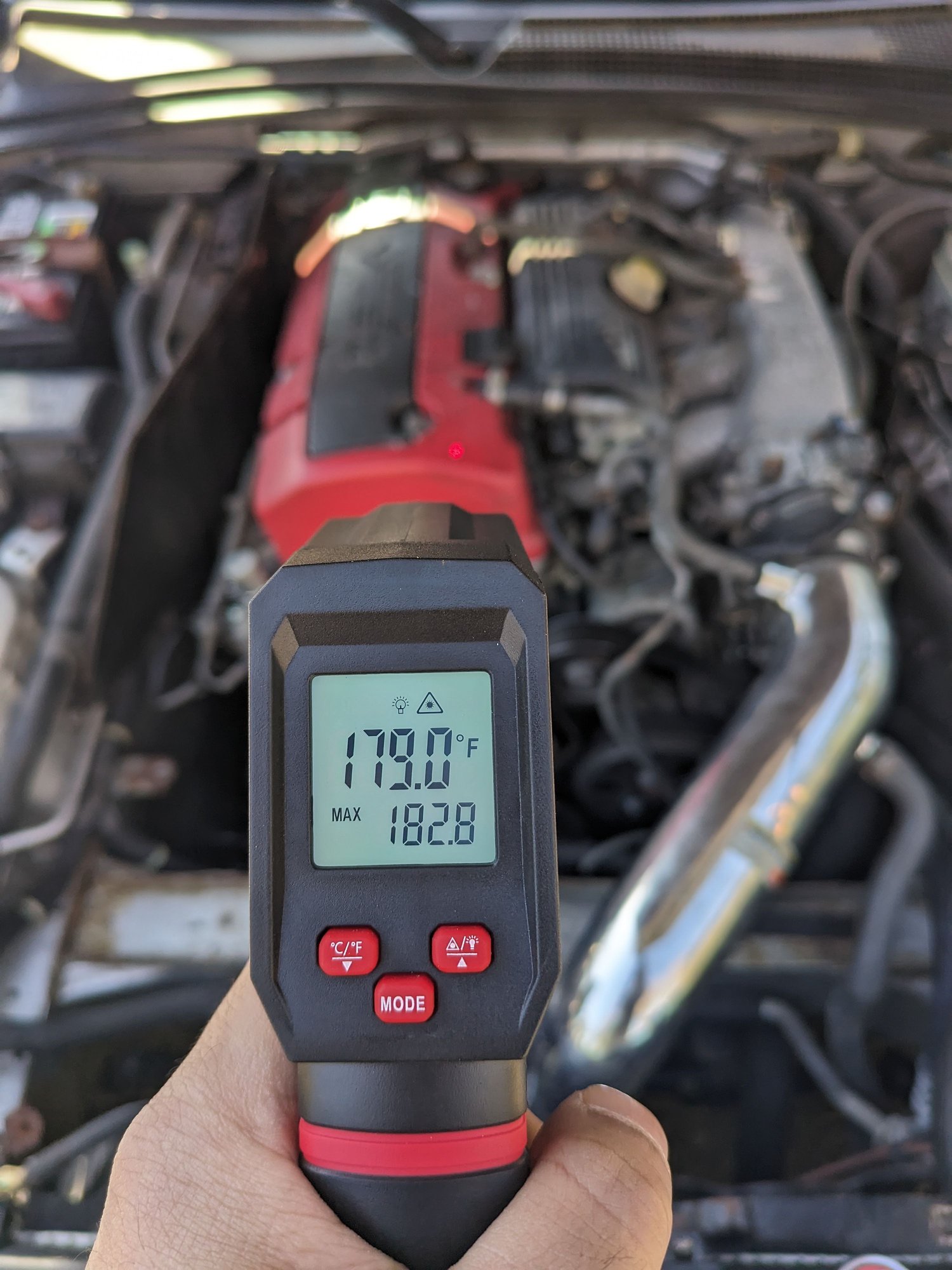

Recently purchased the car and it wasn't in the best shape when I got it. I usually only drive it for short periods that are less than 15 mile drives. The engine and engine bay seem to get extremely warm after just a regular drive down to get gas and back. The temp gauge shows 3 blocks and never goes over. I was dealing with a coolant leak from a smaller old hose, but I got that replaced. I can drive it for 15min, park it outside in ~50°f weather for 30-40min, and the fenders will still be warm if I touch them. Is it normal for these cars to be that hot? I'm not extremely mechanical inclined, but can do some regular diy maintenance and replacements. What can I do to test to see if I have a problem or not?

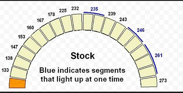

Just scan your engine, radiator, etc., and see if the temp results match your gauge (it probably will, most of the time).
This should allay your fears.

The temp gauge says that the coolant temp it can measure is OK.
