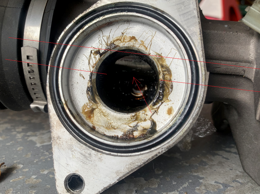

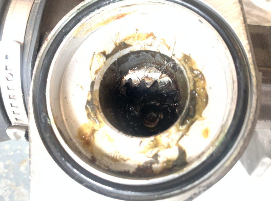

ALSO!!! I discovered a MUCH easier way to get the torque sensor to slide into the rack. This MAY NOT be the correct way to do this, as I do not know the inner-working of the rack outside of pictures/videos of teardowns I've seen so *please*, if you know better please share if this is a good find, or why it would be advised against. After probably a dozen times removing these sensors I got fed up with having to push it super hard and hope it slid in. I did this on my currently functional rack and it made the sensor slide in with near-zero resistance, and I also have zero issues with steering after probably... 5k miles since I installed the rack. I'd imagine the inner-shaft is a hardened steel... so the weight of two beer bottles pushing a screwdriver on it I imagine is harmless. Just my $0.02.
The shaft inside the sensor housing can rotate. I used a thick screw driver on the teeth of the rack to *gently* apply pressure and rotate the shaft so the teeth were facing downwards, where they would then contact the teeth on the sensor which allowed it to slide in nicely. Here are pictures detailing before, and after rotating it gently with a screwdriver.
The two parallel red lines show where the shaft is inside the rack. The arrow in the middle is meant to show where the teeth on it are which are facing away from the camera. I think this is why everyone says "wiggle" the sensor and apply pressure, eventually it rotates the shaft to the correct position. By placing the tip of a screwdriver and applying a very small amount of force, it rotated the inner spine-shaft towards me, resulting in the picture below where you can clearly see teeth. The steel in the rack I assume is hardened.. so I believe the tiny amount of pressure from a screwdriver is negligible, but please don't take my word for this. It's just what I did and worked. I found I was able to do this while on my back under the car and the sensor slid in.
