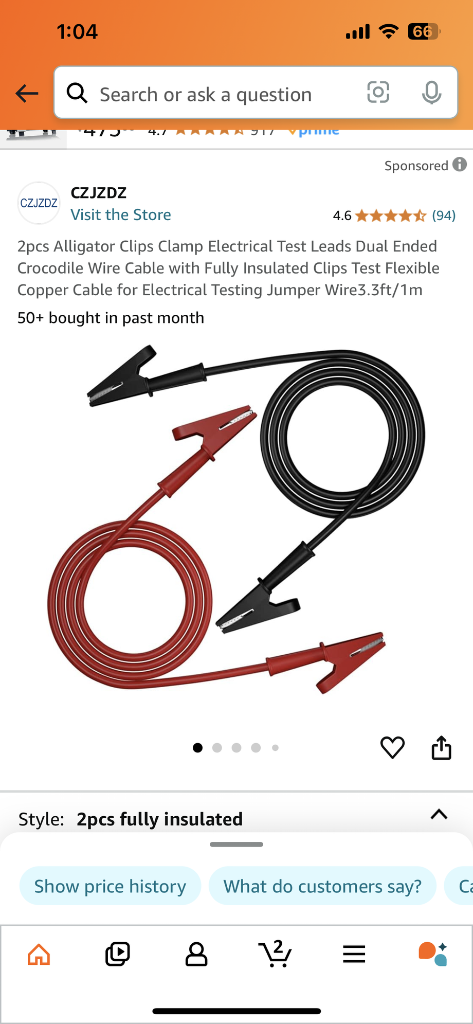

I’m a noobie when it comes to electric stuff so I wanted to make sure do these clips work? I’m going to try the method from the video and connect the brown wire on the eps to a ground

Might try the paperclip method but it sounds scary because i read that some guy messed it up and his car won’t start anymore. What do you think billman
