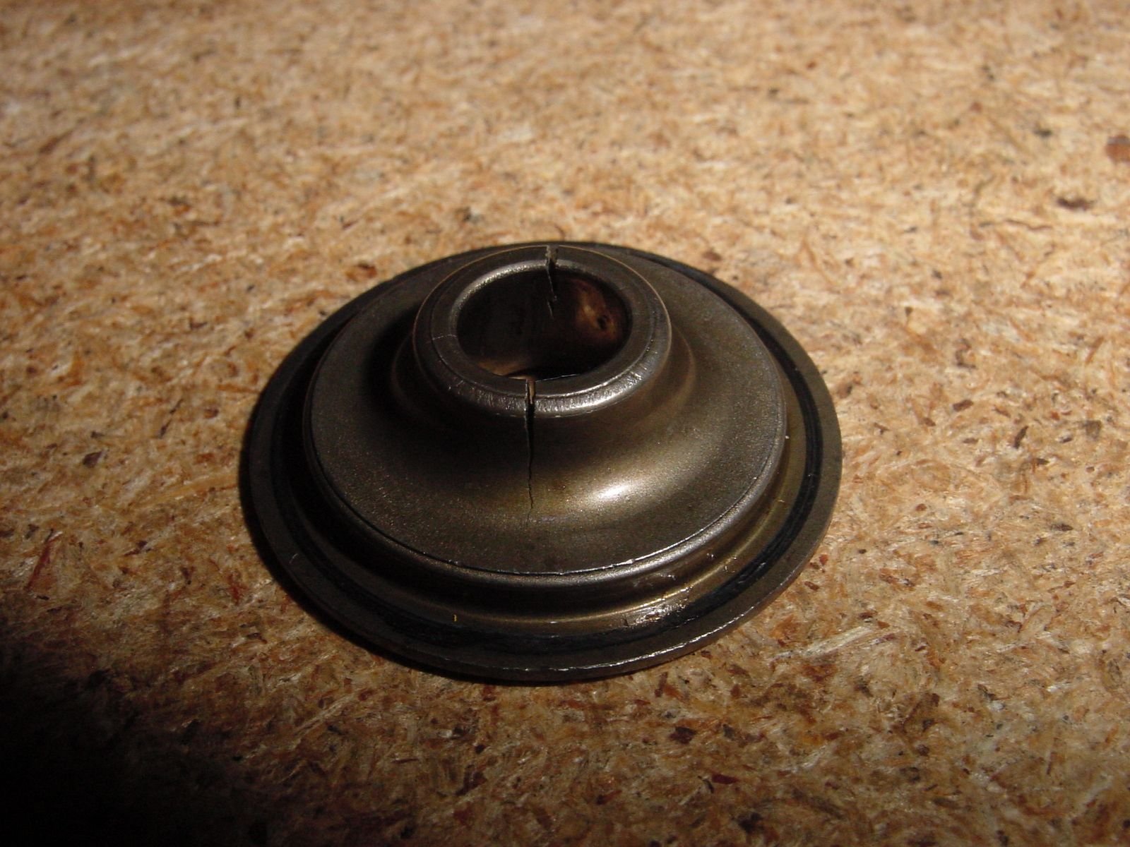

I brought my car to Bill before the end of the summer this year and if I can remember correctly I had 6 cracked retainers. The cracking was not from me because I had never over revved the car. Here is a picture of one of my retainers with a crack slightly longer than that of the original retainer in this thread. As of now I cannot report and problems or valvetrain noise with Ap2 retainers and keepers. I will bring the car to Bill in a while for him to have a look at them.
Tachamp, I appreciate your input. Many of use are interested in this (for obvious reasons), so I hope you don't mind if I ask a few questions.
Did you buy your S2000 used?
If so, was this the first "keeper inspection," since you got the car?
Can you eleminate the possibility of an over rev by a previous owner?
I'm thinking about Modifry's experience here. 180,000+ miles, first with nitrous, and then SC/AC, and no retainer problems. He both autocrossed and tracked the car, and I think he drove it pretty hard, pretty regularly. Are we seeing failures due to production variances, or is there always an over rev or some other factor that is common to all the failures? For example, have we seen failures in cars that are autocrossed by guys who sometimes ride the rev limiter to avoid a shift? I don't baby my car at all, so unknowns like this always concern me a little, in spite of the fact that we're inspecting the retainers every 3,000 miles.
From what Bill has said in other threads, I don't think the weight difference in retainers is enough to matter, and obviously that's what Bill thinks, or he wouldn't be installing them in people's cars. I guess at this point I'm more interested in understand whether or not the stock retainers fail without some kind of "abuse," but there is a lot of interest in this "mod," so keep us posted.
