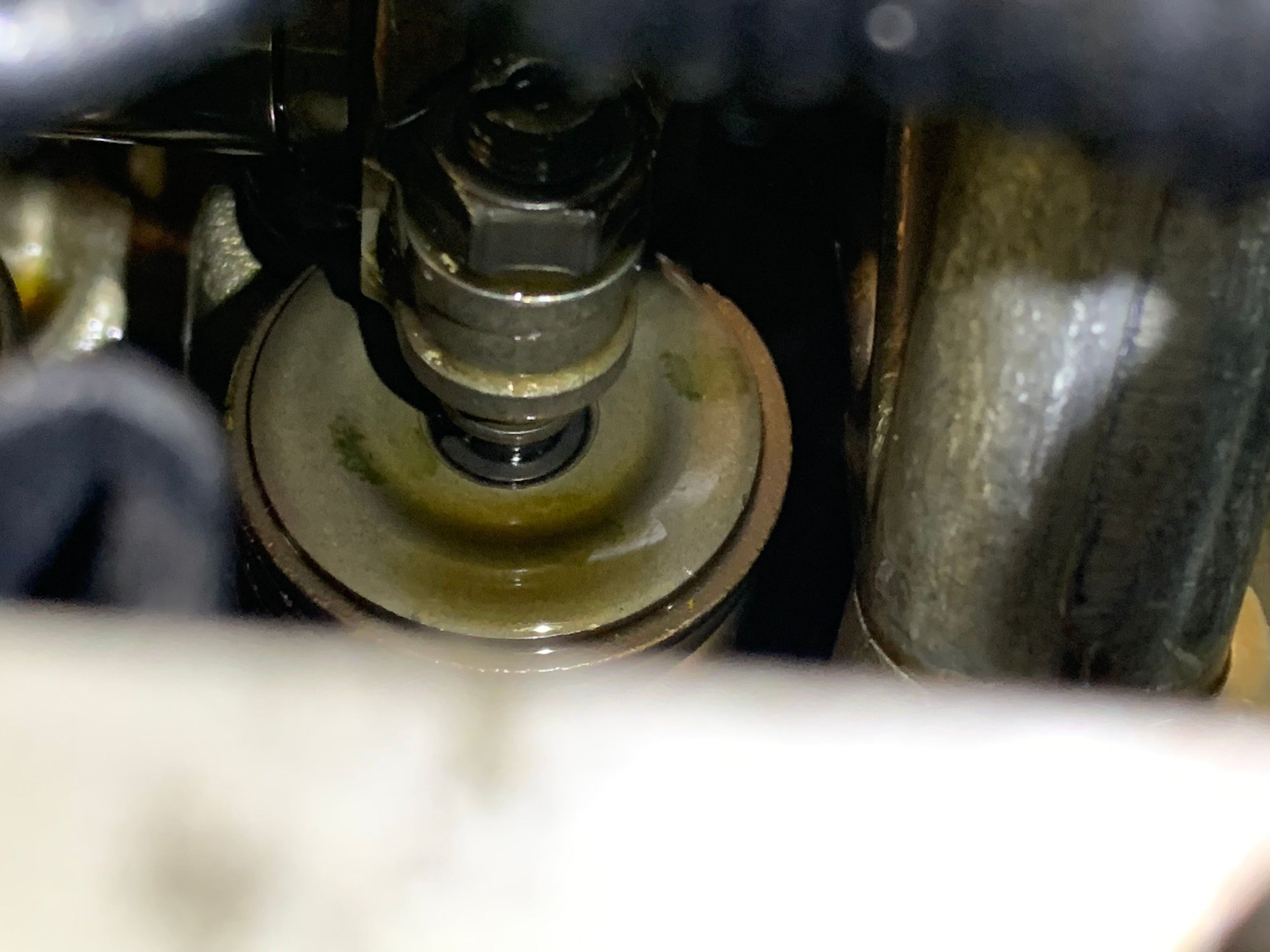

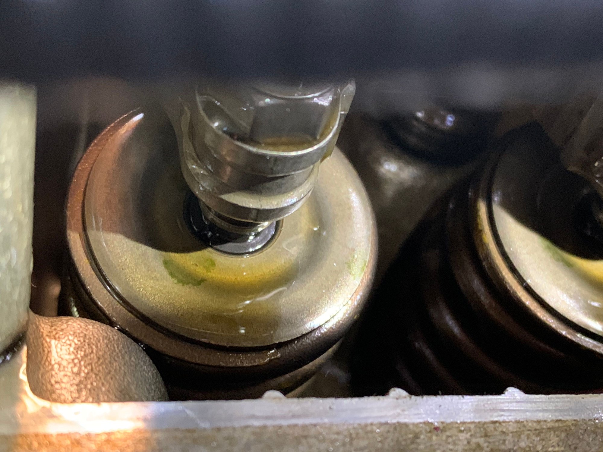

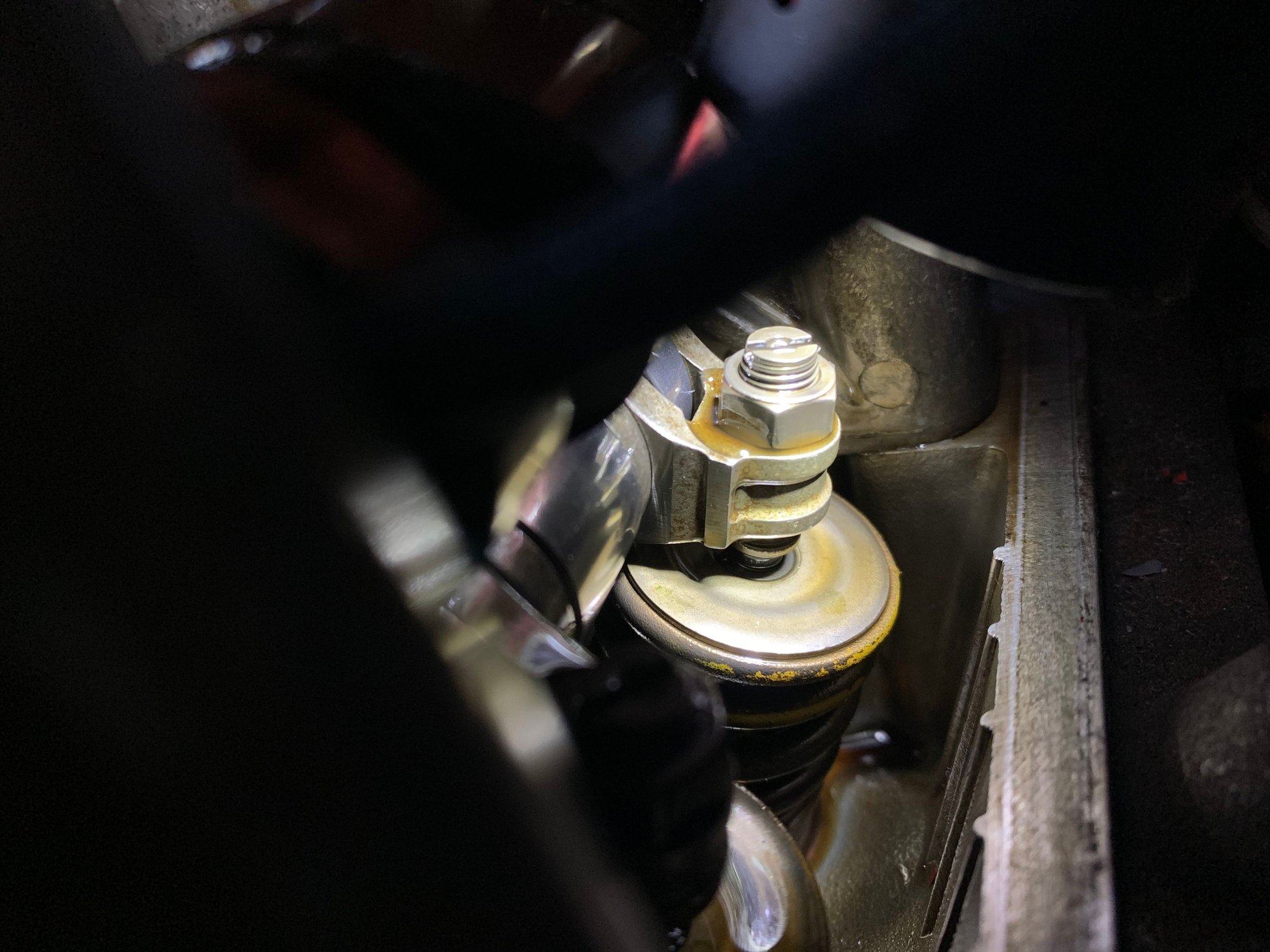

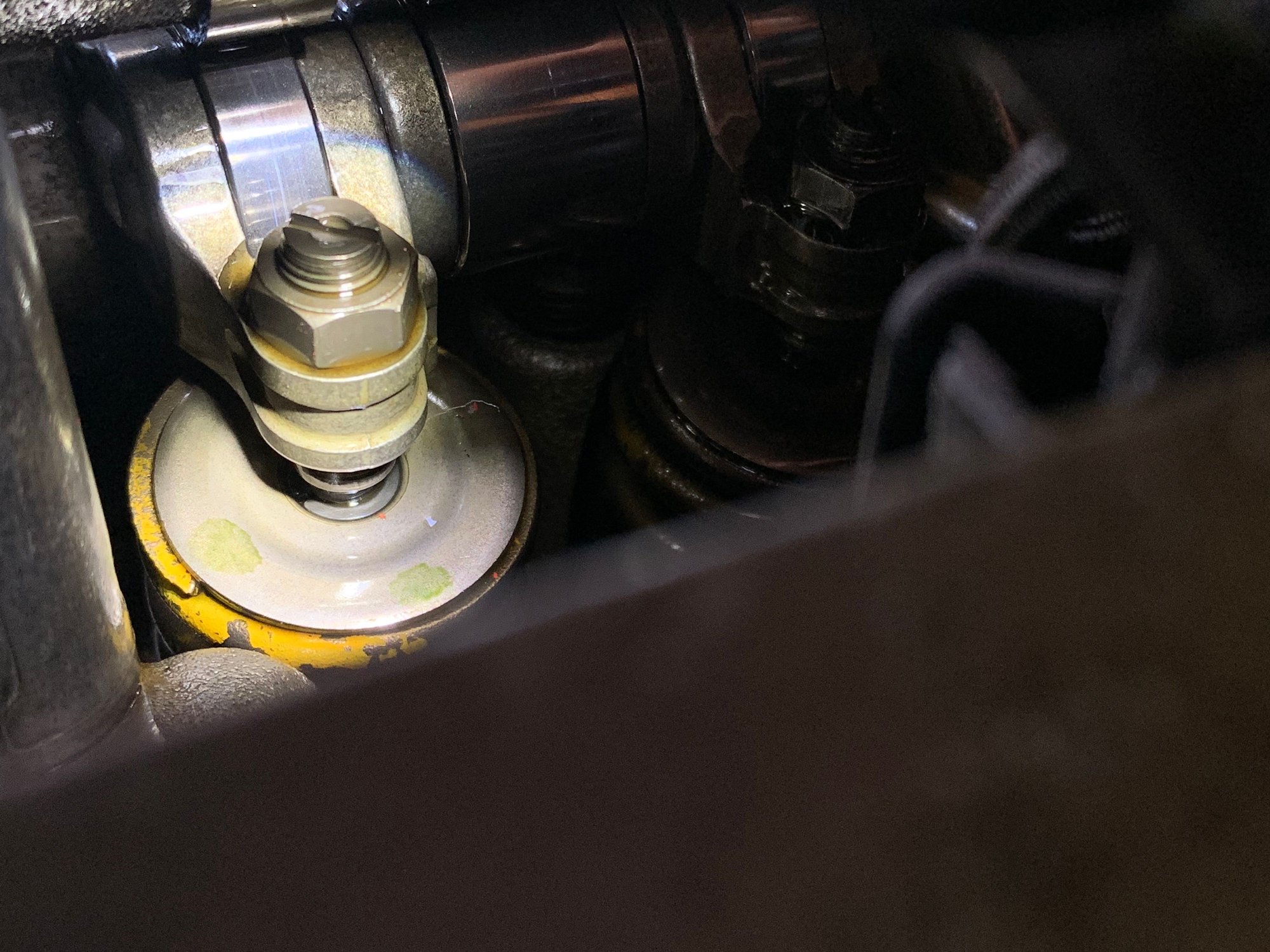

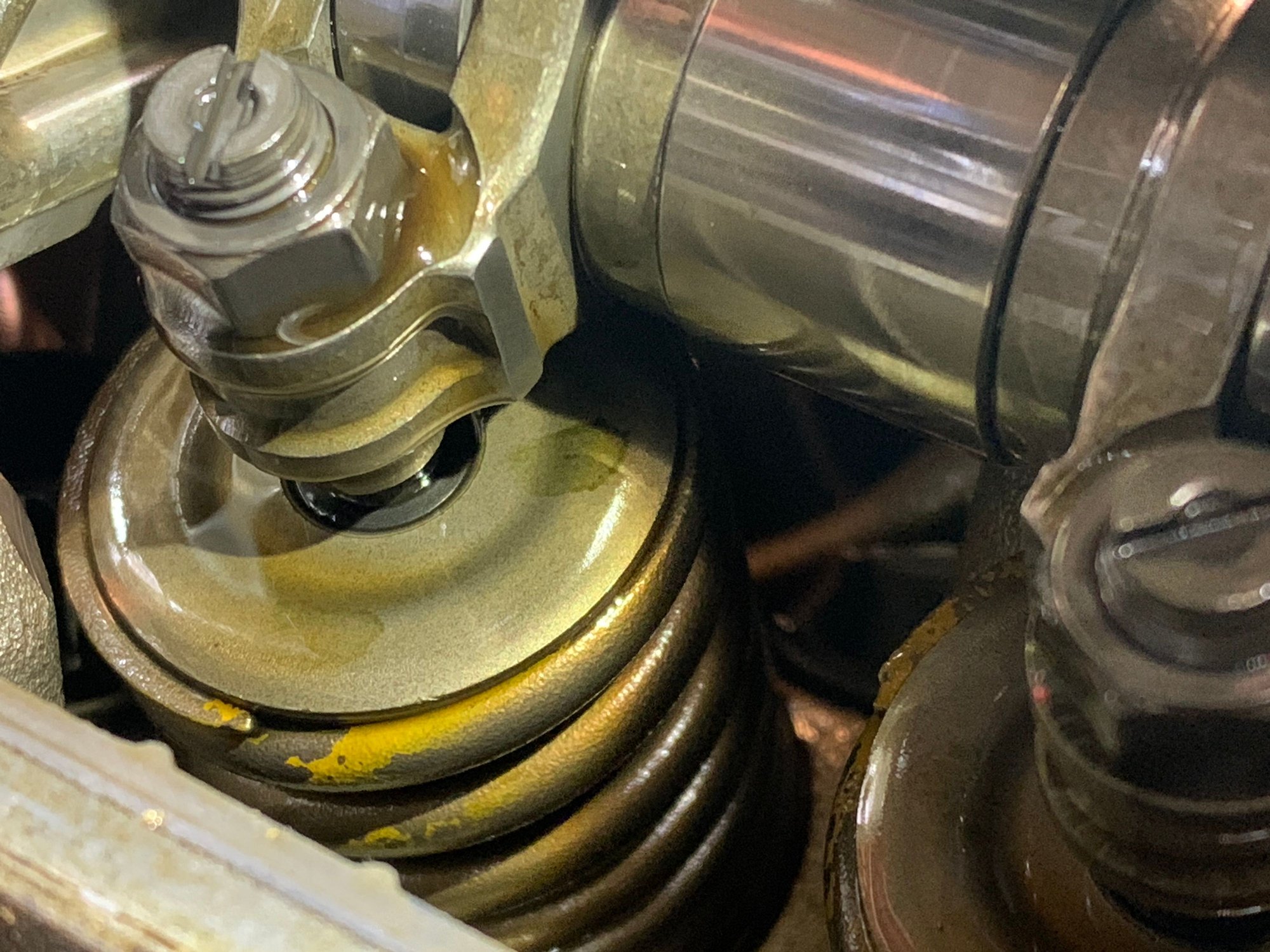

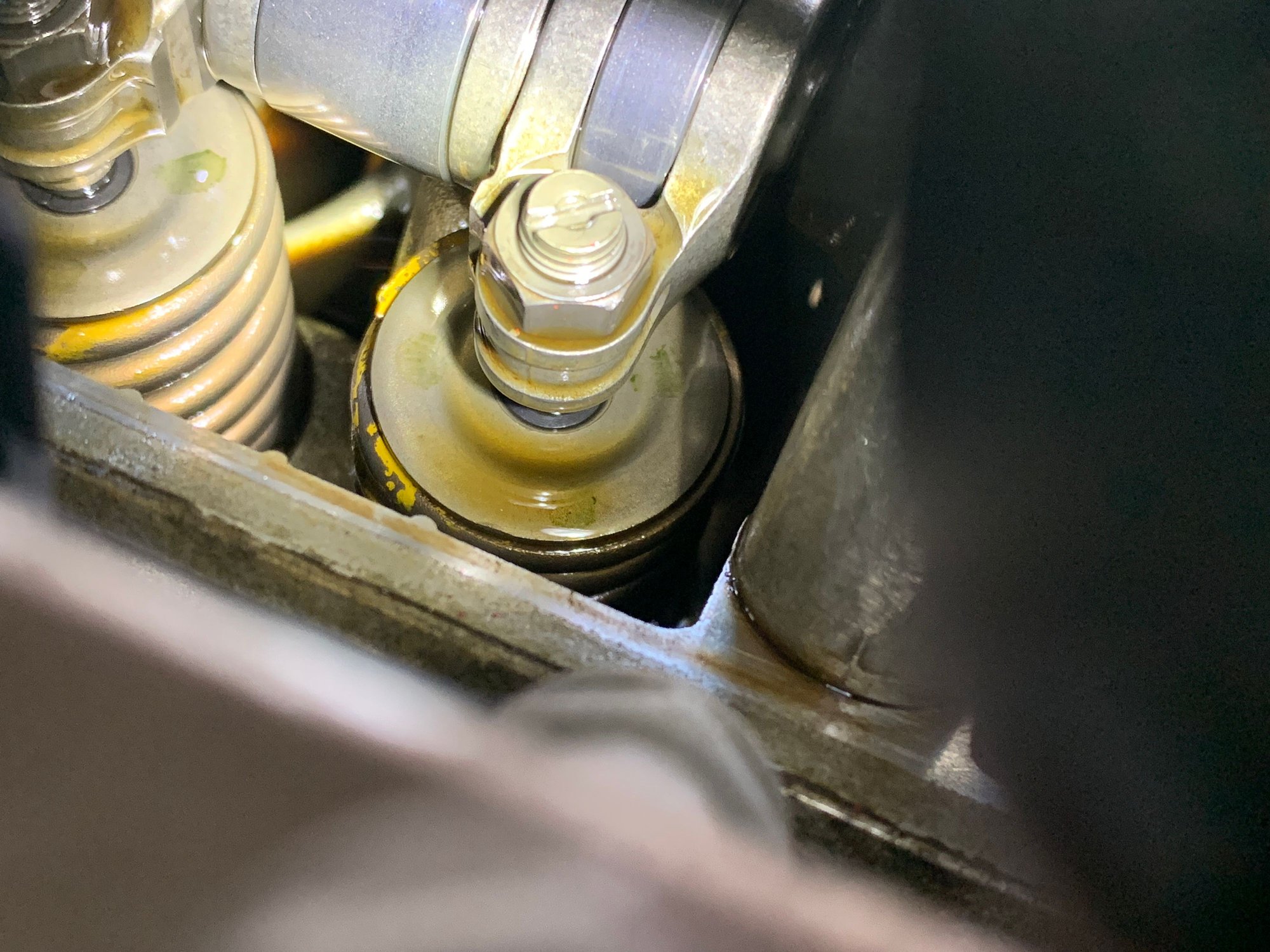

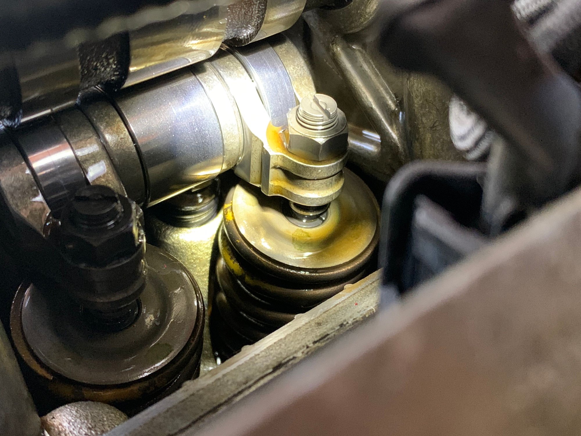

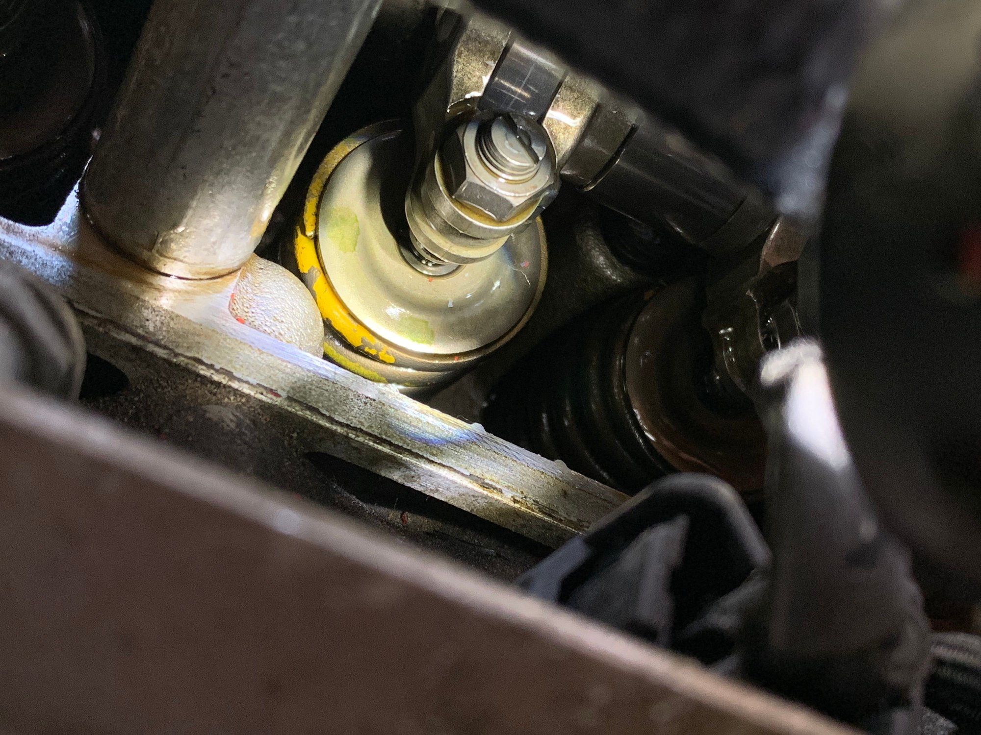

I checked mine at the weekend and I think they look ok, based on other pics I have seen. Can anyone give them a second opinion for me please?

None of those "look" cracked to me given the pictures but angles can be deceiving sometimes. Below is a picture that @Billman250 posted in another thread. Cracked retainer is on the right and you can see how the keeper is more sunken into the retainer in that one.

None of yours appear to be "curled" upward, so you may be ok.
The cracks propogate from the bottom, though. Maybe try using an inspection mirror to see the bottom of them to be sure.
Or just change them.
