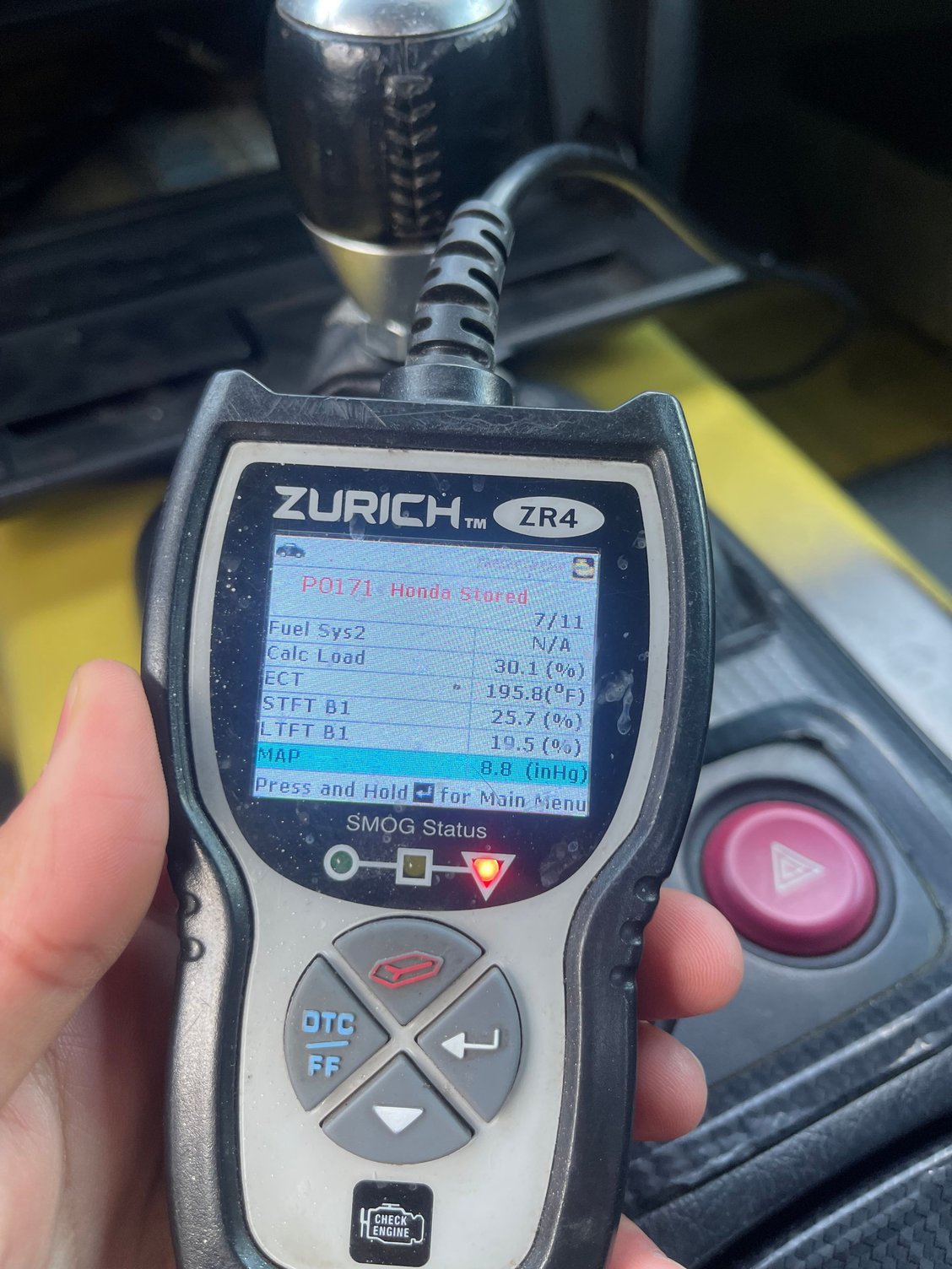

Hello everyone, I have a 2001 S2000 with a f22 swap from a 2005 in it. It has a matching ap2 ecu. I have a P0171 lean code and a high fuel trim in the 28-30%. I have replaced the map sensor, fuel pump, FPR, sent the injectors to be cleaned and flow tested with no luck. The car also has a slight misfire with no CEL. I couldn’t find any vacuum leak when I smoked the car. Any help is appreciated.

What is the STFT at idle? Can you post the freeze data?
Is the intake manifold gasket brand new oem?

at idle the STFT was in the high 20s and no the intake manifold gasket is the same one as I didn’t remove the intake.
