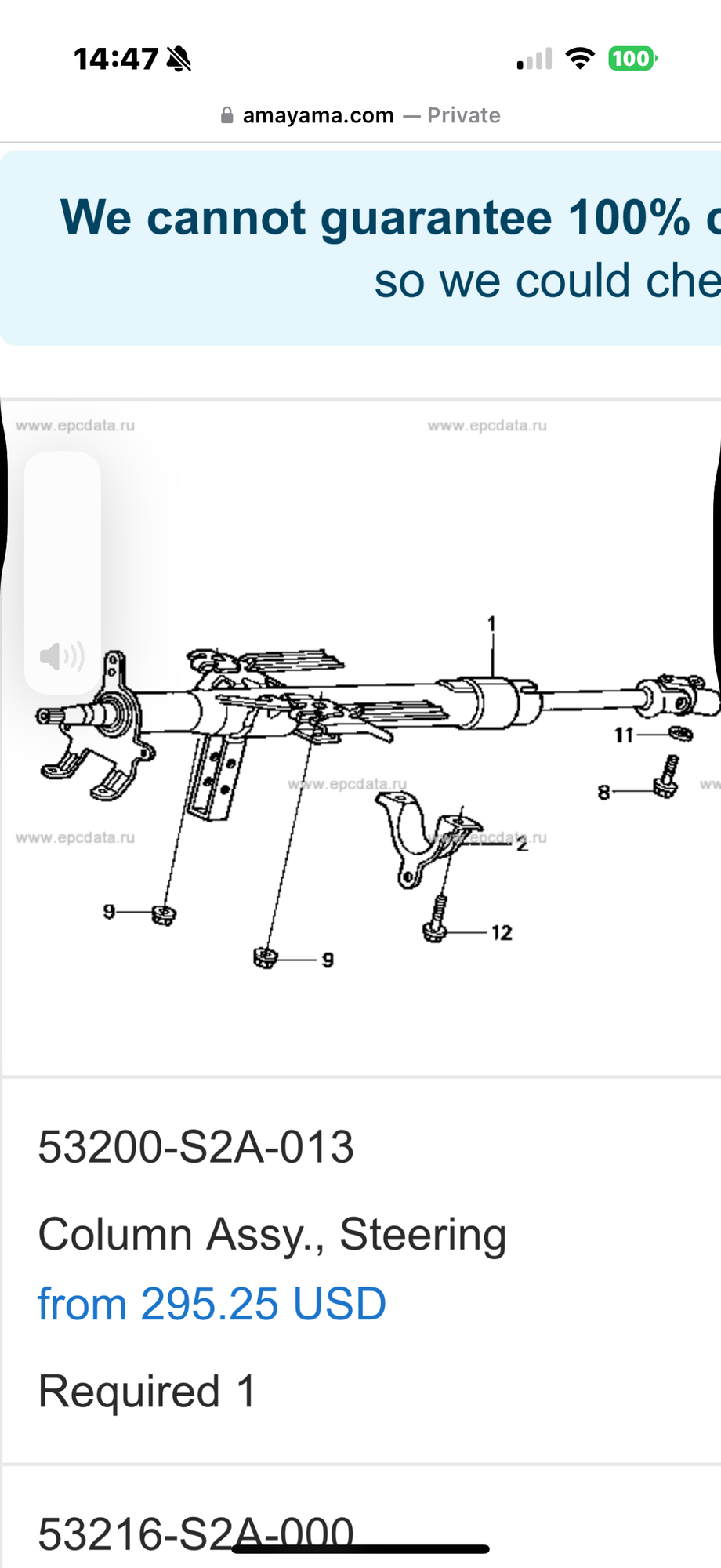

In my infinite wisdom, I managed to snap one of the studs that holds up the steering column. I still have the two at the back and one at the front holding it up so it doesn’t move and feels pretty secure, but would like to see if there is a fix for this without completely removing the dash?
Pic for reference:
It’s the stud that #9 in the pic tightens onto. The other #9 and both #12’s are currently still
Holding the steering column in the place.
is there a way to drill a hole through where the stud should be, rethread a hole, and then secure it in place with a new bolt?

There's no stud on the column the stud is mounted on the chassis.

You'll likely have to remove the dash to get to the stud from above.

and prob not enough material to drill out and thread unfortunately.

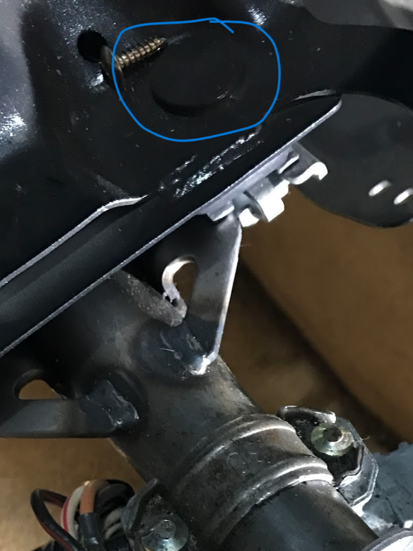

so after weighing all the options (not many) this is my best bet. Drill a small pilot hole then send a self tapper through just to secure that side. Like I said, the three other bolts are holding the column up securely so I’m not too worried about this but would like that side secured for peace of mind. I’ll report back with how it goes.
does anyone happen to know if there is anything directly behind that stud that would prevent a self tapping screw from going up through it?

Wiring? Cluster? Better put a hand up there and feel around unless you wanna dig this hole deeper.
Honestly the dash isn't THAT hard to take out.
