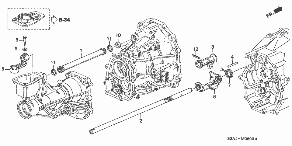

It was likely not left out by the OP, but from a previous job.
Only need to lower back of trans to replace it. Check majestic diagram for where it goes.

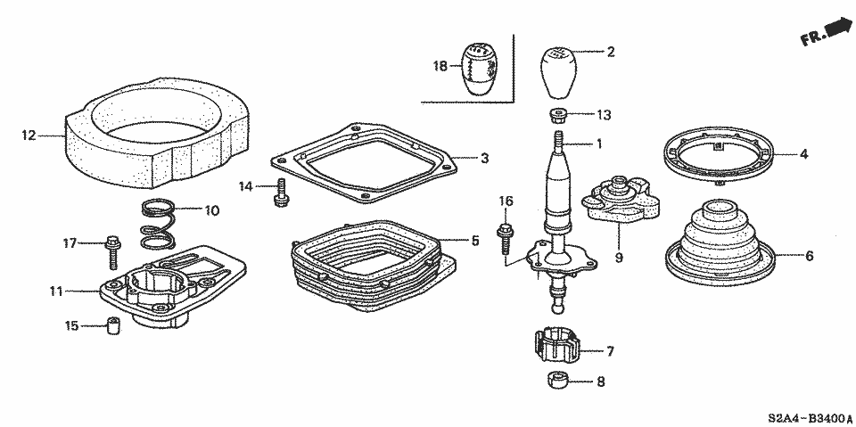

They left a pin --- which should be inside the transmission --- on the gear shifter --- inside the car's interior? Wow!
Is it Number 4, on this diagram? Thanks!

It is not #4.
It goes between the trans housing and that B-34 top plate.
Need to refer to another diagram, it is not shown here.

Thanks! Maybe #15, in this diagram?

#15 is correct, there are two of them in there.
If either are missing, the top plate will not center itself over the shift pawl, #5 in the first pic. This will cause the shifter to stick in the down position when engaging reverse gear.
