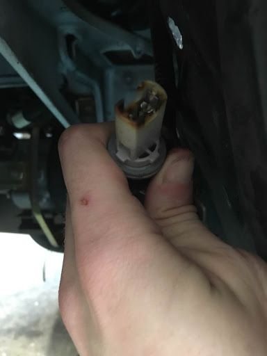

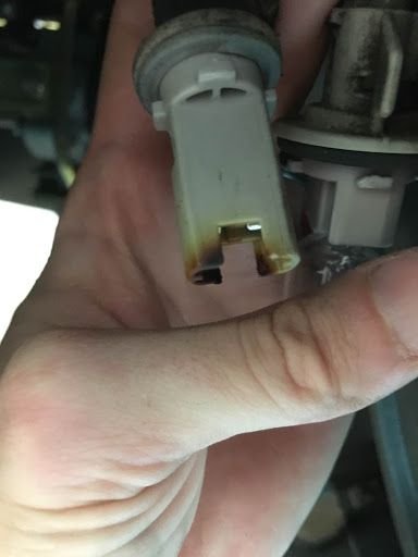

I went to Sylvania's website to check the bulb compatibility and wasn't sure it was correct. So I first took the bulbs out and discovered, There is a separate bulb for parking lights and turn signal lights..... I'm guessing AP2 is dual filament.
Eitherway, the bulbs both look good, but the ballast on the otherhand… Pics added.
What could have caused this? Old Age, water damage, incorrect bulb, batter charger while connected to car?

Parking lights and Turn Signal lights are 2 different bulbs. They look like the same because they're both behind the same long diffuser.
The socket looks burnt possibly due to the bulb running hot. LEDs don't run as hot.

sockets with darkish heat marks are normal on these cars, the incandescent bulbs run hot, mine looked similar. Go LED for the parking lights they should last the life of the car.
