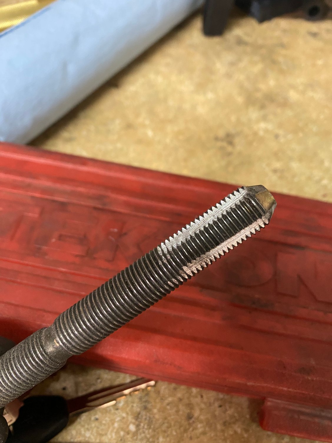

Soviet, how many threads are affected?
You can take a grinder, and taper out the first 10-15% of threads, clearing a path for a tap or the bolt.

Originally Posted by noodels
When I were a lad many many years ago..
anyway.....
get a oem bolt,cut grooves in like a tap tool,with plenty of oil ect ect..and use that to clean it all up
This here.
No idea but I may be able to give this a shot this weekend. I have several spare subframe bolts laying around from partouts.
anyway.....
Yup we use this method at the factory for many applications. Works like a charm.

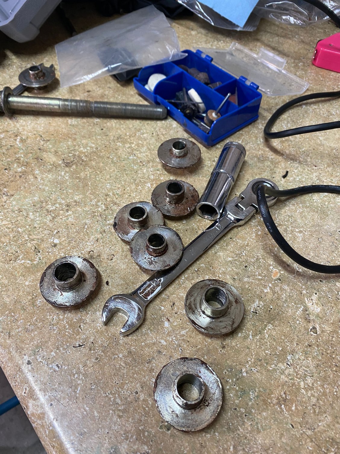

Didn't get around to try this out until today when I decided to install some used rigid collars I got from a car I parted out.
You guys are absolutely brilliant! After running the custom tap through the bolts went in like butter. They torqued down no problem.
