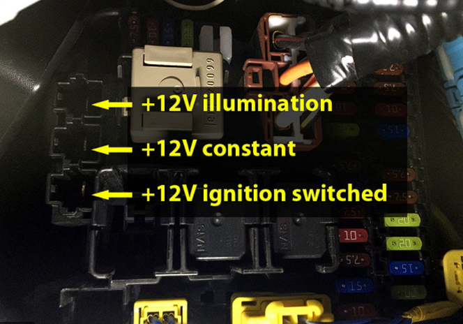

I know ScienceOfSpeed sells one, but for people outside of US, where shall we find one? Does Honda dealer have it?
Thanks in advance.

thank you so much! Looks like it's this one:
HD-250 Connectors (cycleterminal.com)
PN: 6098-0234

Standard 1/4" (5.4mm) female connector available everywhere. You maybe only need one (1) but 200 is $13. Small packs available at auto and hardware stores worldwide.

...Chuck, no it's not available everywhere. OP wants the factory connector...reading comprehension is a crazy thing.

It's as much a "factory connector" as the aftermarket motorcycle connectors linked earlier. Not a darn thing connects there at the factory. I's just a 1/4" connector that will accept a standard 1/4" female connector.

OP needs the complete connector, that includes the plastic plug which is from Sumitomo, which is the OEM plug installed at the factory.
Chuck is suggesting a metal terminal which is made in China, which is not what the OP is asking for. Cycle Terminal even has bare Sumitomo brass terminals on that page at the bottom, which is what Honda sources! The OP and others want exact OEM replacement, and like so many others, he found it.
