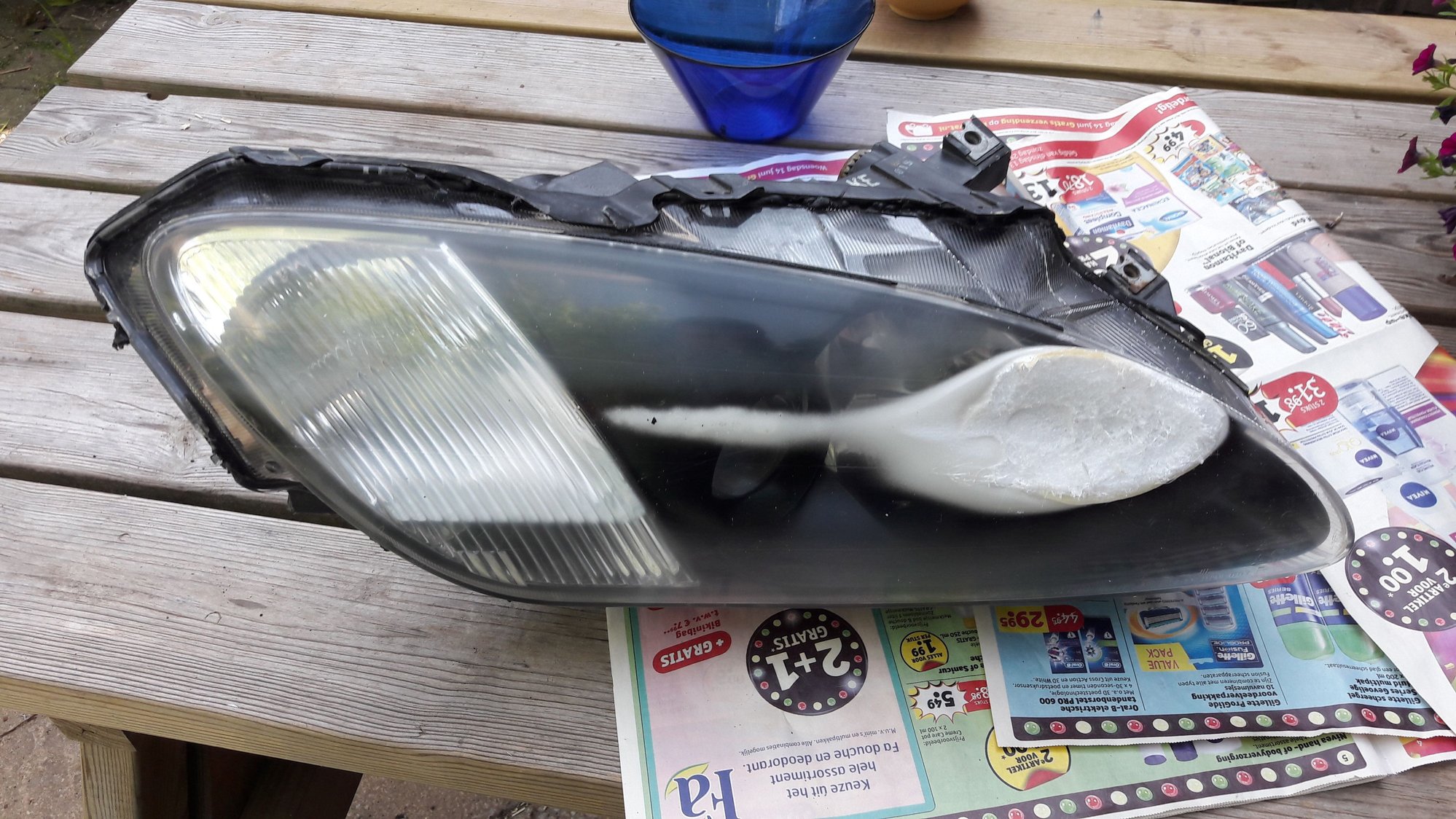

Unhappy Headlight melted
Dont ask.
Any idea how to fix ?

Buy a headlight for parts off ebay/craigslist, heat gun the old lense out, get some butyl/windshield sealant and some small clamps from HF, line the tab with it (but not too much), and clamp them together.

It'll buff right out.

Could you link me with a headlight for parts? i cant seem to find any scrap ones :/
What do you mean with this ^ ^?
He is obviously joking, new lens will be needed.
I know you said "don't ask" but WTH happened?
