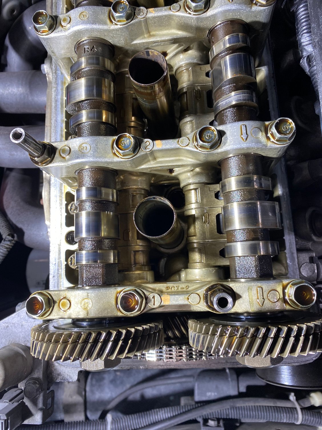

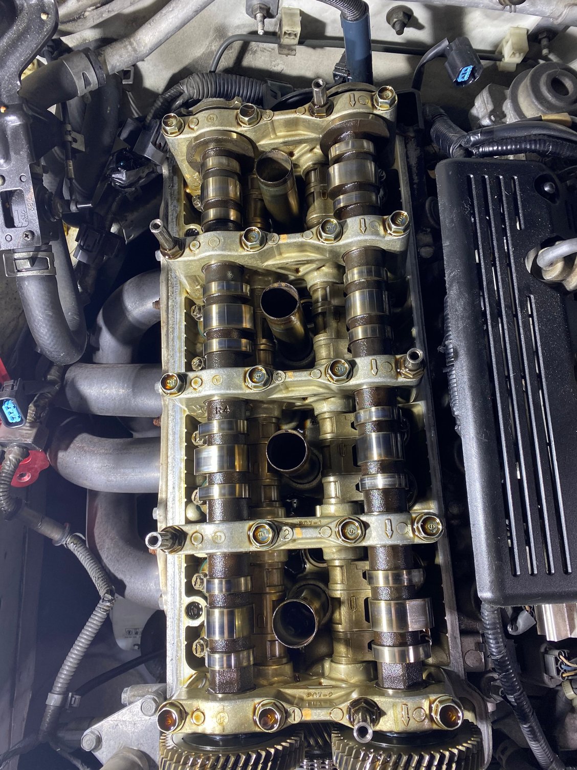

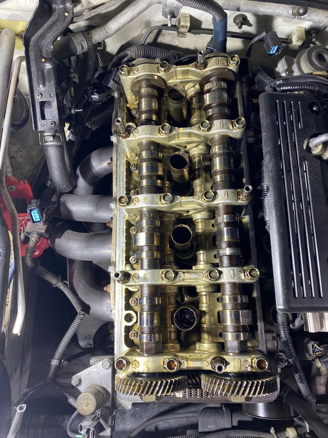

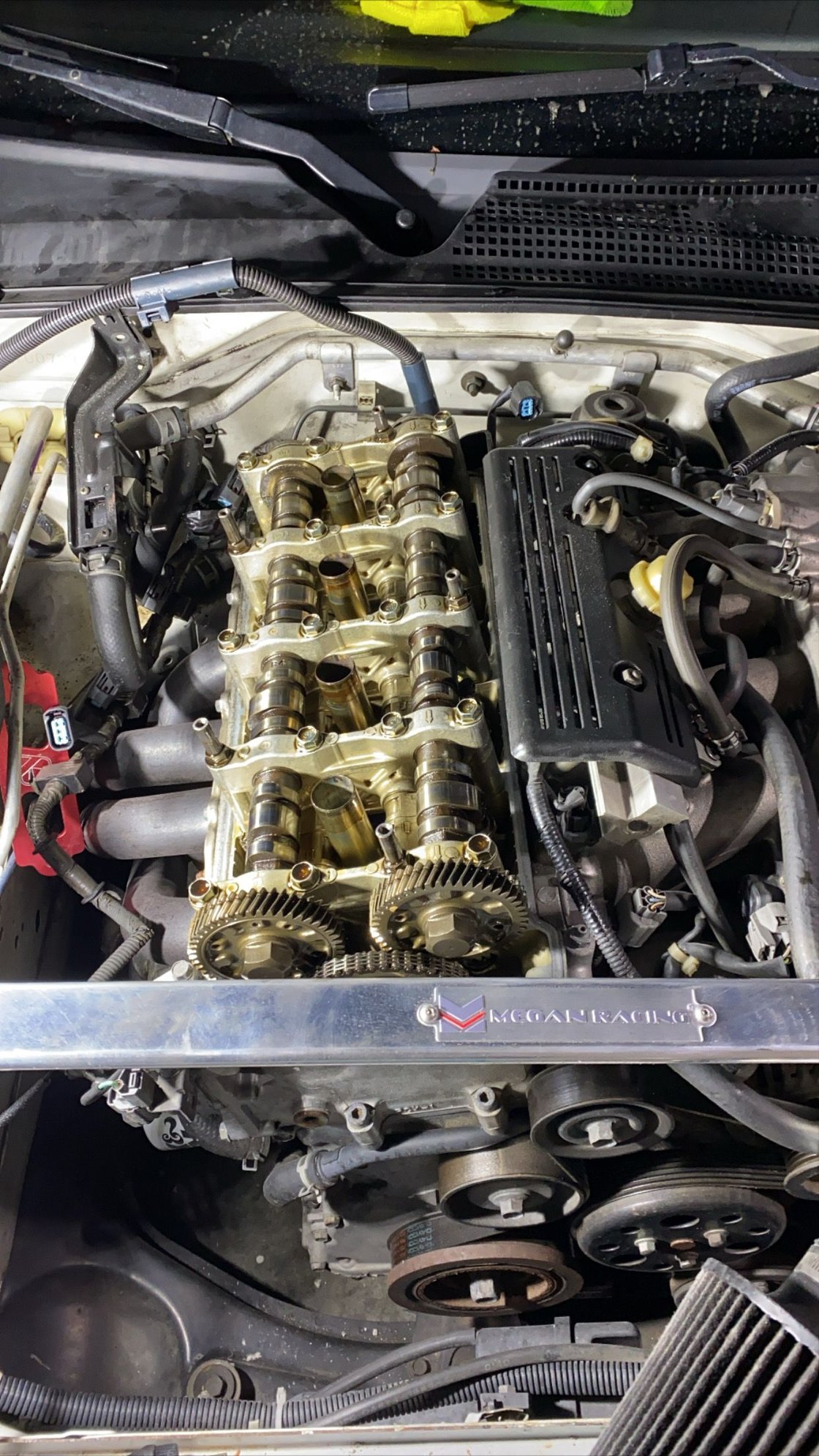

H
Removed the valve cover, I can’t tell whats wrong, every thing seems fine, do I need to do a compression test? Only thing I know how to do is probably removing the cover lol, not a expert on cars, thx guys!

You need to actually remove the cams before you can inspect the valves. Follow this thread to step 3c. Keep track of the order and orientation of the cam holders (see red circles below and note the arrow pointing to front). Get a light in there and look closely at each valve, keepers/retainers and spring. When re-installing torque to spec AND in the right sequence.
If you don't feel comfortable doing this, take it in to a shop.
Could be the light but your 3rd intake valve looks scored (yellow circle).
