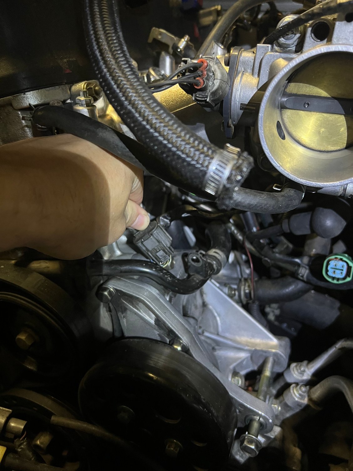

So it looks like it’s a coolant line, but I don’t know what clip bolts to the line to hold this electrical component does anybody know the names so I can order one? Thanks.

That should be the crank position sensor. It clips onto a metal clip similar to what you find on the VTEC solenoid.

The connector in your hand appears to be for the crank sensor. If so, it clips to 32111-PCX-000, which is missing in your photos.
part #22 in this diagram
https://www.hondaautomotiveparts.com...ntake-manifold
Part #22 fastens to the #1 intake manifold runner's upper stud. The connector clips into it.
BTW, your TPS connector is bashed to peices.
