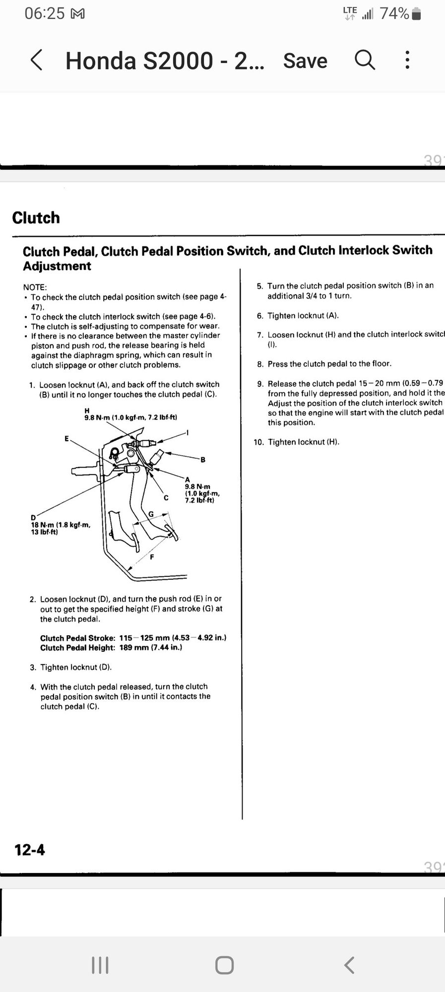

Switch on the clutch is defective?

Check the clutch interlock switch plastic plunger is not broken. Gets brittle over time. Had this happen to me.
