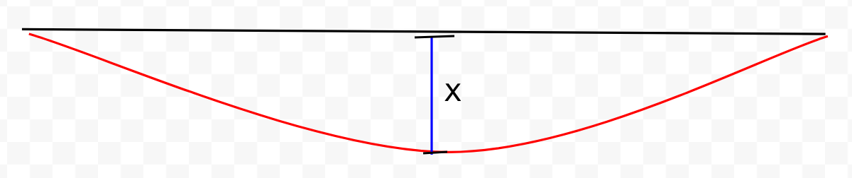

Been through a couple threads about tightening the throttle cable, but haven't seen anything definitive on measuring the slack. Am I looking for option A, from a flat plane, or B its total distance from one extreme to the next (or something entirely different). Doubt it'll make that much of a difference but before I head out to the car figured I'd ask to make sure its not too tight or loose before I reinstall it.
A)
B)

A would be correct if this was tank, APC, or other very heavy track, B would be correct if this was bicycle or motorcycle chain, but it isn't.
What's measured is the free play in the system, the length the cable has to tighten before the throttle moves -- a lineal back and forth cable movement, not sideways measurement. Free play in the mechanical throttles (not DBW) should be 15mm - 18mm movement.

How could you actually meassure the free play?
You need one person sitting in the driver seat and slowly pressing the pedal. Annother person is peeking under the hood, watching the movement of the cable and notice when the throttle actually opens.
And of course you need some markings on the cable: 0, 15 and 18 mm.
Or do i miss something?

cable deflection not free play,so no need for another person in car
edit:seems to be 4-6mm

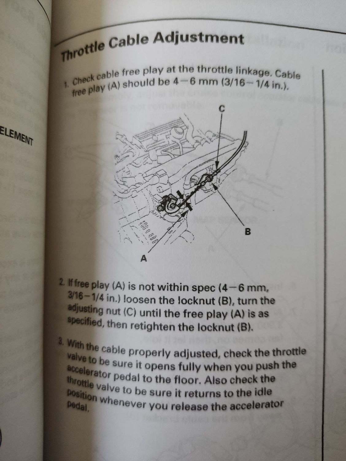

Just had a look in the English and German FSM.
The slack should be meassured like Option A), from a flat plane, as seen in the picture. It should be 4-6 mm.
