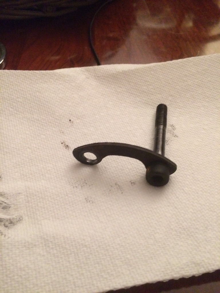

So I was driving from a friends and I heard a metal clank. Something had fallen from the ground but it was at night and I couldn't find it. Later my friend found it (sent a pic to me) and I cannot figure it out what it was but most likely a drivetrain part. It's a semi circle and thin and a hole in both ends with a long bolt through one of the holes (the other may have fallen out). Anyways, later I was driving and in 5-6th especially 6th the transmission was shaking very hard (atleast the shifter). It also made a very LOUD noise. Like marbles in a tin can. (Note I'm new to this forum and remember seeing a thread that mentions it but I can't find it at the moment). Anyways as I was driving slowly and came to a stop the transmission felt like it just POPPED AND FELL. It'd go into gear but I tried to give it gas and go and the whole transmission would shake HARD and make this very very loud noise. Imagine a rod knock but 10x louder. It could be drive shaft but I'm not sure. Anyways.. Car can't drive at all. Some strangers helped me push it into a lot and as in neutral it'd sometimes do that pop noise and shake. Any help would be great IMG_5461.jpeg IMG_2253.jpeg

Here's a photo of what fell out http://s50.photobucket.com/user/Levi...g.html?filters[user]=145371392&filters[recent]=1&sort=1&o=0

Here ya go! Driveshaft washer.
There are six (6) of them. Three on each end of the drive shaft. One bolt fell out long ago! I suspect there are more missing or at least loose!

Can't thank you enough Chuck! This helps a lot. Now as to figure out how to tow it to the shop. I wonder how the washer got knocked out

I am not the original owner I'm the 4th but that very well could be it. How much do I need to torque it down to? If you know

Assuming we're talking about the driveshaft bolts listed here, then it looks like only 24 lbf/ft.
