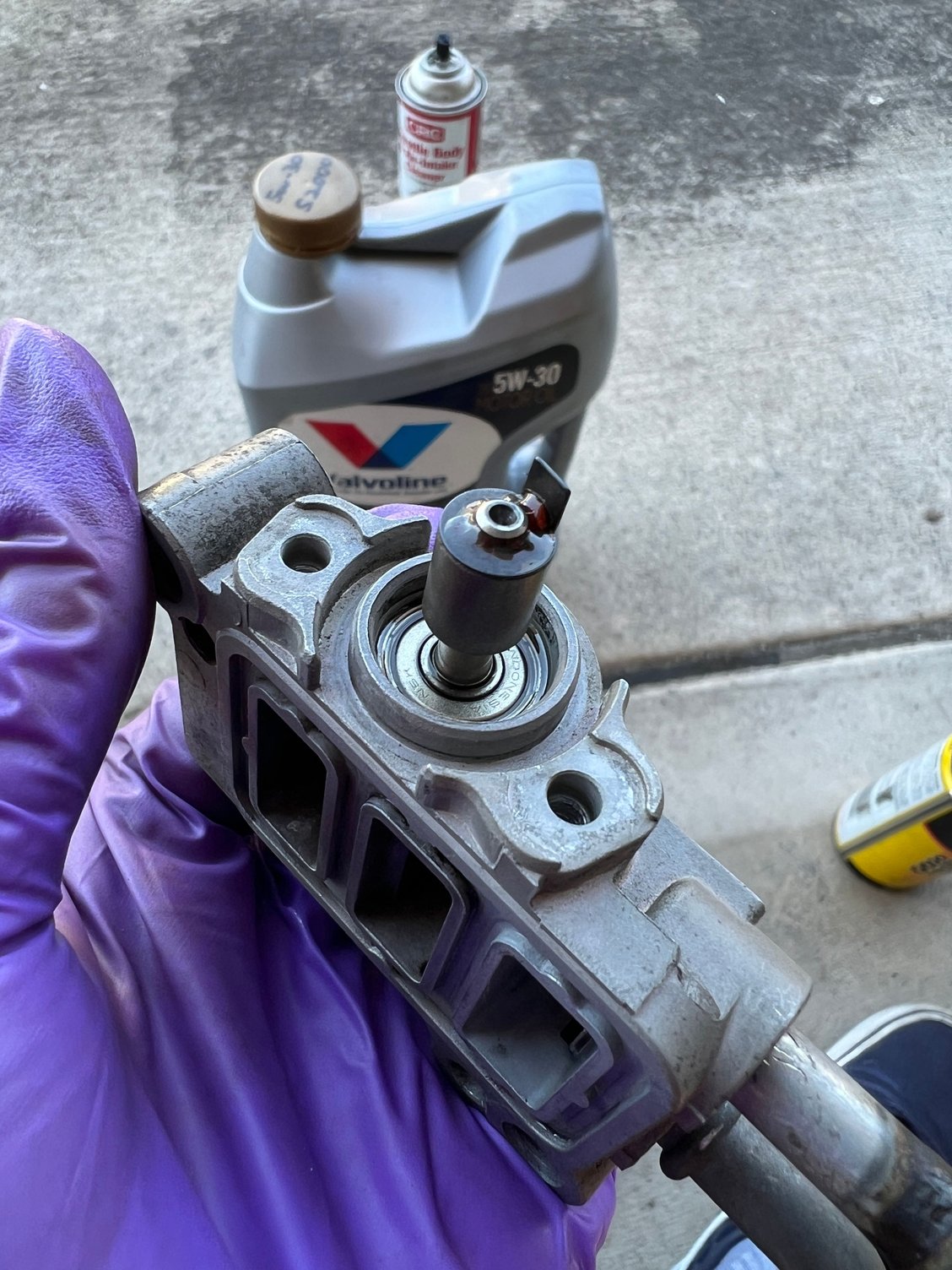

This is the bearing right? I added one drop of engine oil.

So one brand new Honda gasket and lubing the bearing with a drop of engine oil and spinning the shaft I pulled the Backup 7.5 fuse then put it back after 60 seconds.
Let the car idle with no other electronics and the idle hunt was still a thing. The car was not up to temperature so I held revs to 3000 RPM and after the car warmed up the idle hunt is gone.
I'll let the car sit overnight and test it with a cold start to see if that did the trick.
