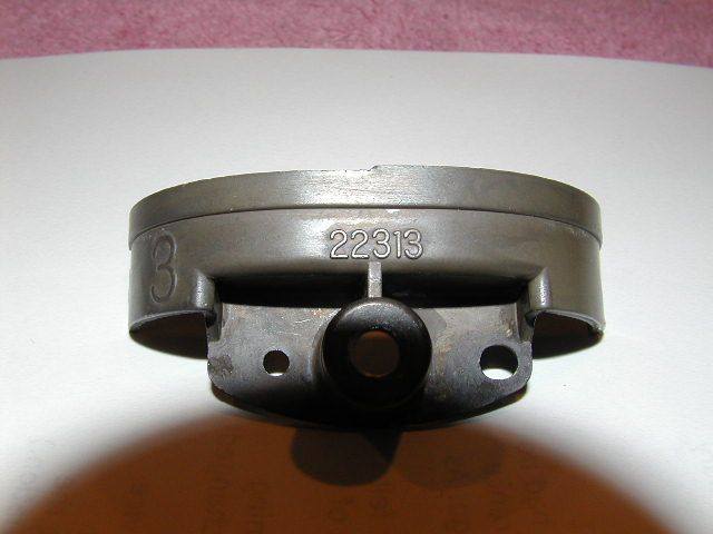

OK -- I have been there. done that. There is a baffle in each headlight that causes the beam pattern. The left and right hand drive baffles are not interchangeable because of hole/pins that are different between between the two baffles. Somewhere in history on either this board of the NY Metro board I posted a detailed description of how I did the physical changes to the JDM light baffles to make them suitable for use here in the states. A search should find the whole article. I note that the pics were posted in early January, '04 if that will help find the article.
Some pics of the baffles and the changes are here:

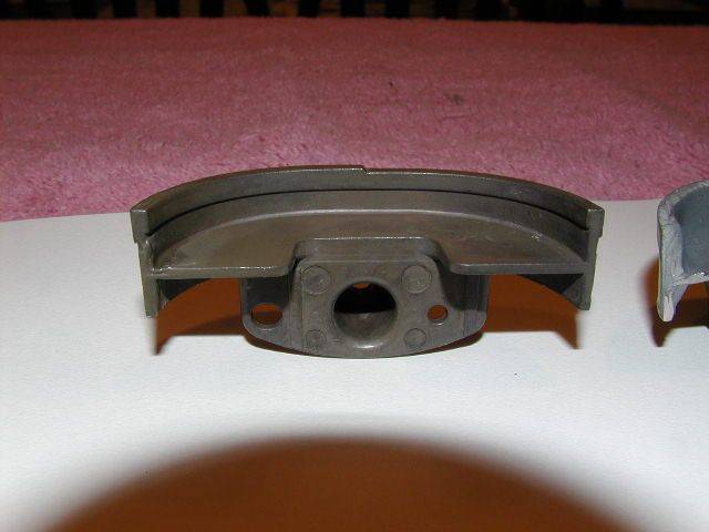

Here is a good pic of the JDM (modified) and NON-JDM (nonmodified) baffles, see the way the alignment mounting holes are different:
modified JDM:
stock U.S. baffle:
