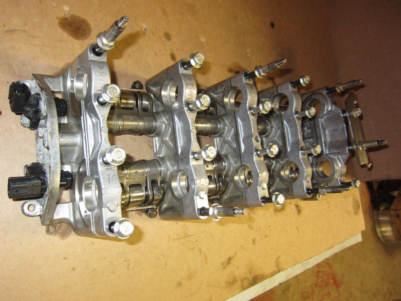

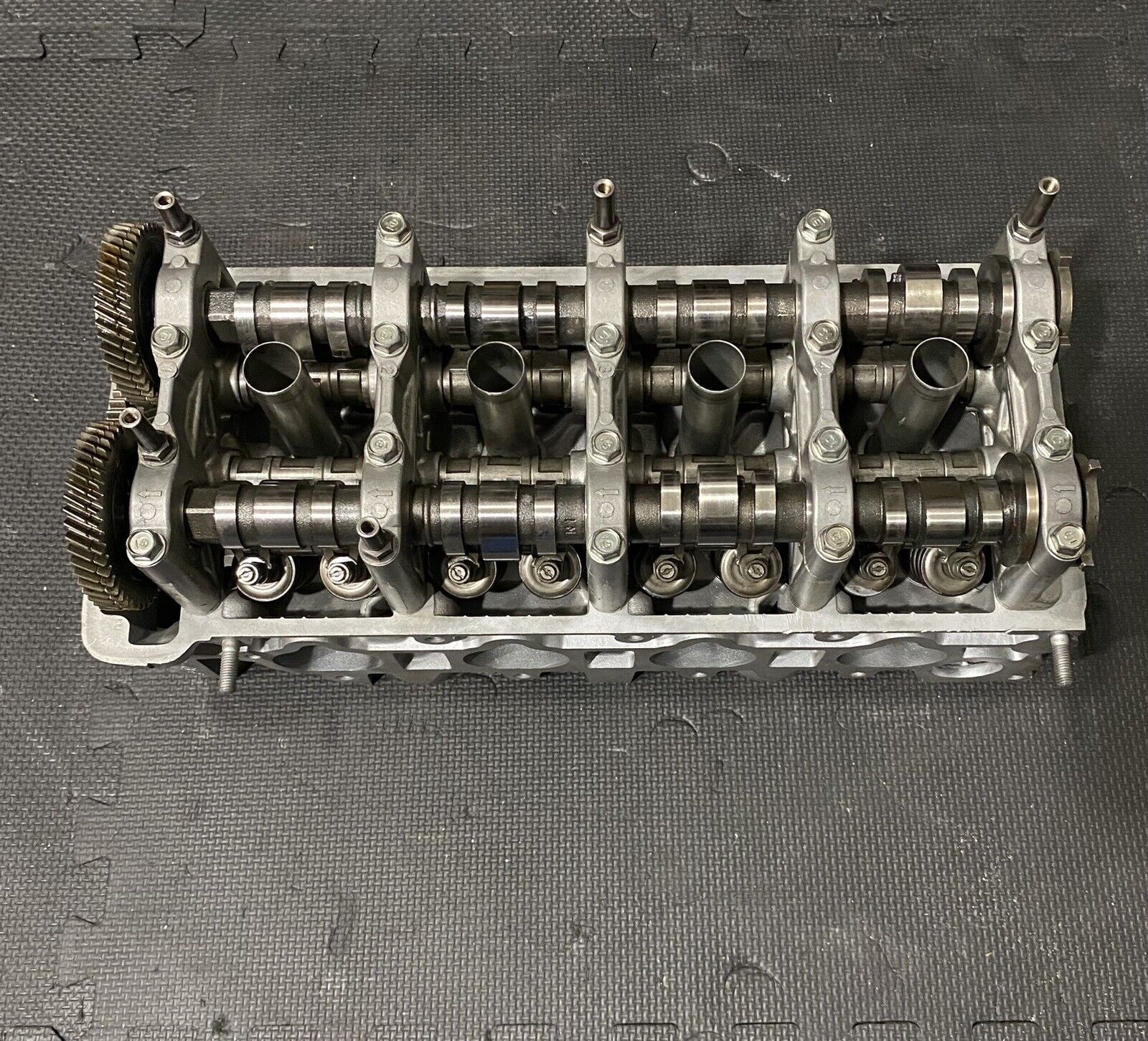

It looks like the K20 cam caps and VTEC rockers is very similar to the F2x cam cap and rockers. If anyone has a spare set K series cam caps would they mind measuring them?

OK, they are not the same, they might measure the same(I'm still not sure), but the K series has variable valve timing, the last cam cap is too big, it won't fit in the F2X cylinder head. You would have to machine the first and last cam cap to fit, provided of course they measure the same otherwise.
