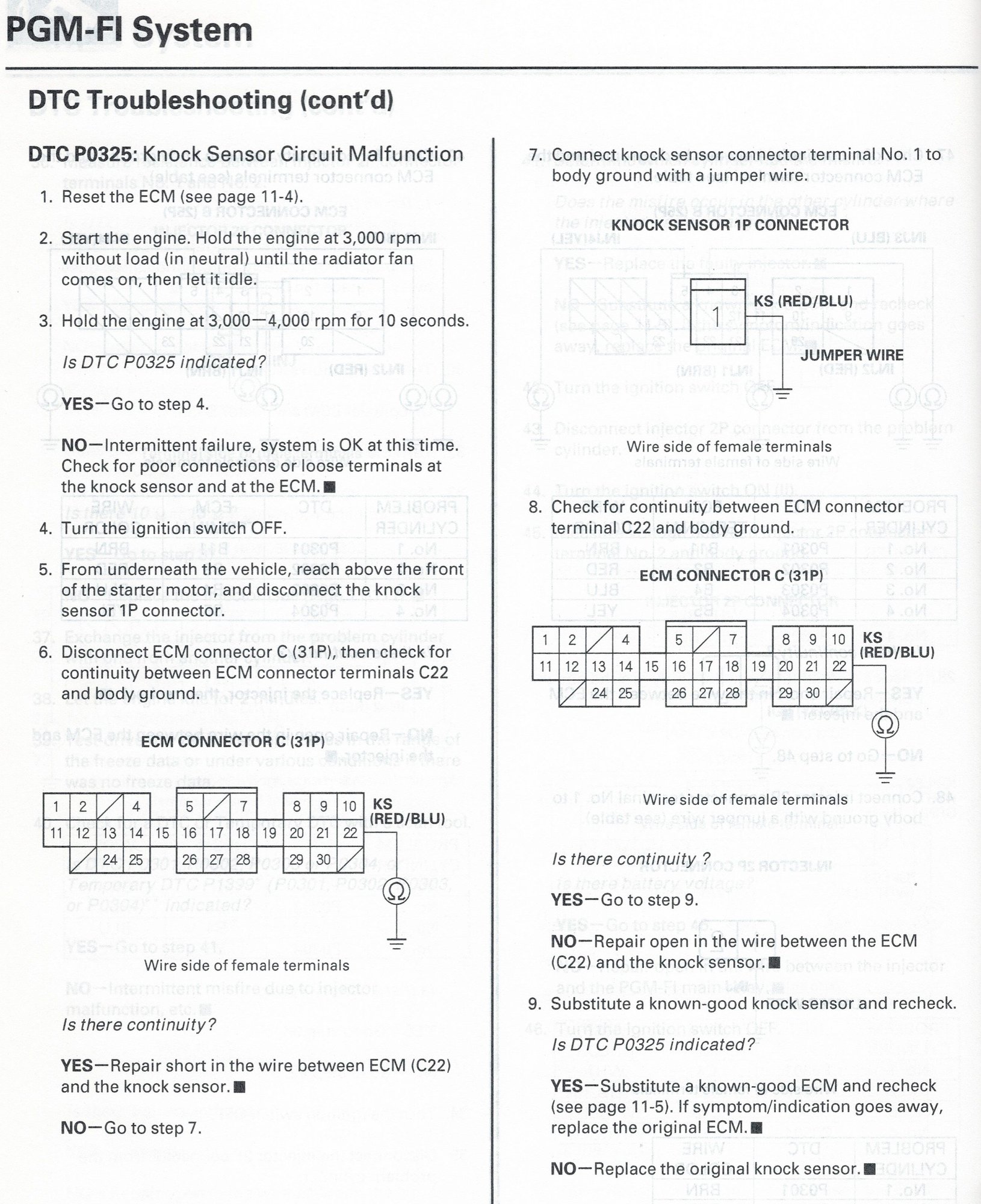

so there is an issue with the knock sensor circuit... damaged wiring, etc. should be the first thing you check.
That sound is related to car vehicle speed. So likely not related to the motor at all.
Troubleshoot the knock sensor circuit.

By the way, instead of going to get my shop manual out and taking pictures I shamelessly stole the one @windhund116 posted in another thread about this code
