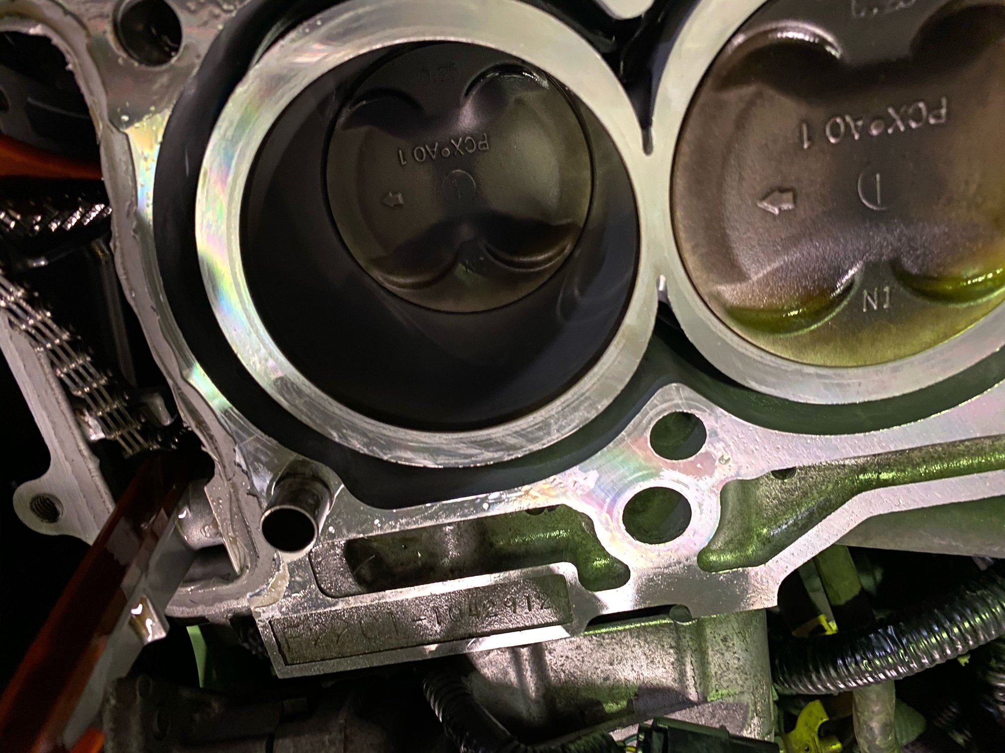

Update from visit to inlinepro yesterday...
Inline Pro pulled off the head to reveal Cyl 2 and 3 scored badly. The pistons are lighter colors on the outside meaning they were heated up for some reason, but only on 2 and 3. Inline Pro is going to tear down the rest of the block, pull the pistons out and apparently the piston rings themselves will tell us whether this was ignition or fuel related.
Some of the theories we have so far are:
- Maybe bad injectors? I'm running ID1050X that I bought new and only have a few thousand miles on them as of now. Inline is going to flow test the injectors this coming week... but even they said they would be surprised to see 2 bad injectors.
- Possible bad coilpacks on those cylinders? If the coilpacks were going bad and firing at the wrong time, it could cause detonation BUT.. I would be getting CEL misfire codes like crazy, which I am not.. so this theory doesnt hold that much water either.
- Can a tune cause this? Inline Pro and myself agree that if it were the tune, all of the cylinders would be messed up?
Any ideas anyone??
here's the carnage:

What ecu are you using?
and speak plug tips were covered in oil?
