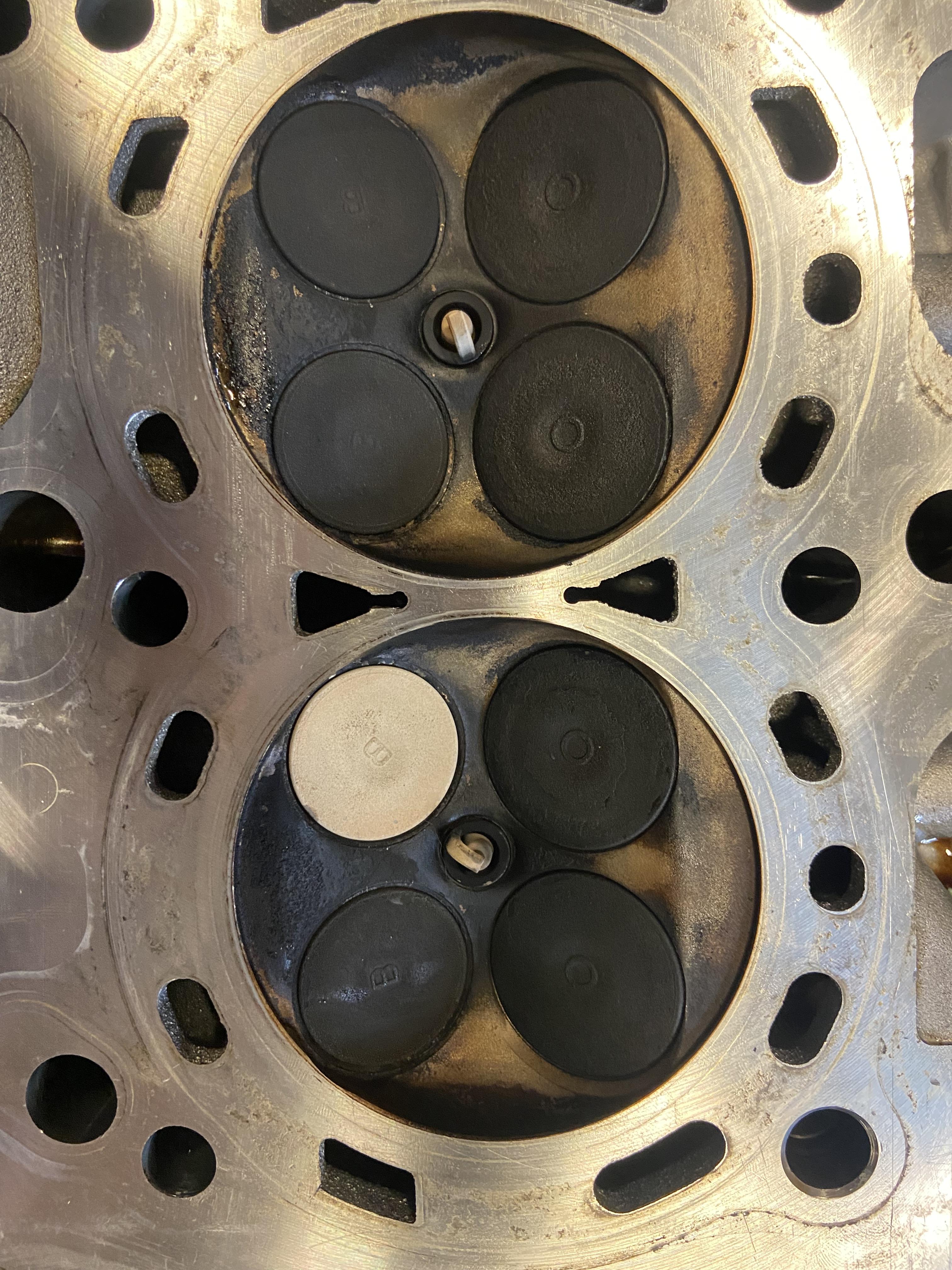

So, I got a small camera off amazon that connects to my phone and I peeked inside cylinder 3, and while the light on the camera was kinda weak, with piston at bottom dead centre, I can definitely say the cylinder walls are pretty clean and shinny. Also, no marks on the piston head. I did the same thing on cylinder 2 since it's a companion cylinder and can say that its walls look the same as cylinder 3, and cylinder 2 is a healthy cylinder.
After that, I undid the exhaust manifold and took a few photos, not great photos, also there is a lot of carbon buildup, probably from all the short drives I make.
Cylinder 1
Cylinder 2
Cylinder 3
Cylinder 4
I know, I know, they look terrible, and I really could not tell anything from the photos since I don't know how to read valves.

Hiss from exhaust pipe could be burnt exhaust valve(s). Number 4 looks like exhaust stem may have gotten a little cooked.

When you run the engine with little to no valve clearance on the exhaust side, the valves do not cool off sufficiently. They cool off by transferring heat to the valve seats when they're closed. Diminishing clearances provide them a smaller amount of time to cool in each cycle. When clearance gets to zero, there's no cooling and exhaust gases start passing them and heating up the seats behind the valves, causing the seat material to be more brittle and the valves to recede quicker. The whole issue exponentiates itself which is why it's important to keep on top of adjustments.
I had mine adjusted 3 times in 24k miles before I finally found my burnt valve. To my knowledge, only on the second adjustment in that window were the exhausts noted to be tight. On the third adjustment, they were still in spec. The damage was already done. If yours are in spec and gas is getting by the valve, that indicates the valve is not sealing due to the seat/valve contact being no good. Based on your car's history, this would be my bet.
I don't have enough experience with this to judge by your stems. Cylinder 4 looks obviously burnt to me but maybe they're all ashy and I just don't know it. Would hope someone more knowledgeable would chime in on the looks of them. It would definitely be worth it to try to re-do a leakdown in a quiet environment. You can also use a balloon over orifices to figure out where it's going. Put a balloon over your exhaust and see if it fills up. Idk how easy it is to tell but I've heard it works and it makes sense.
