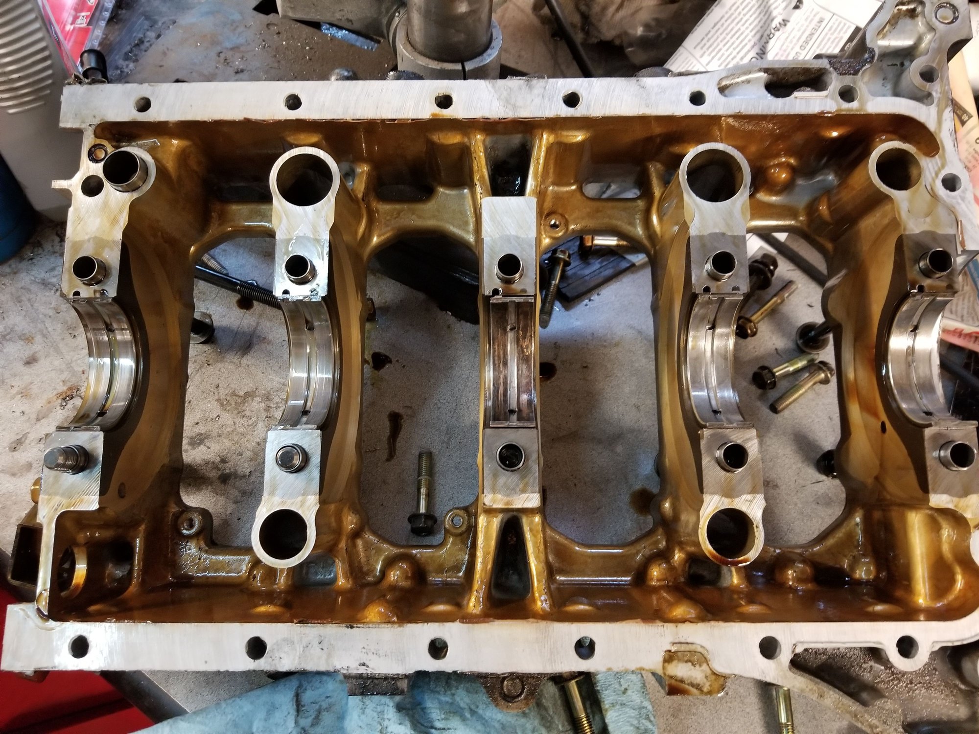

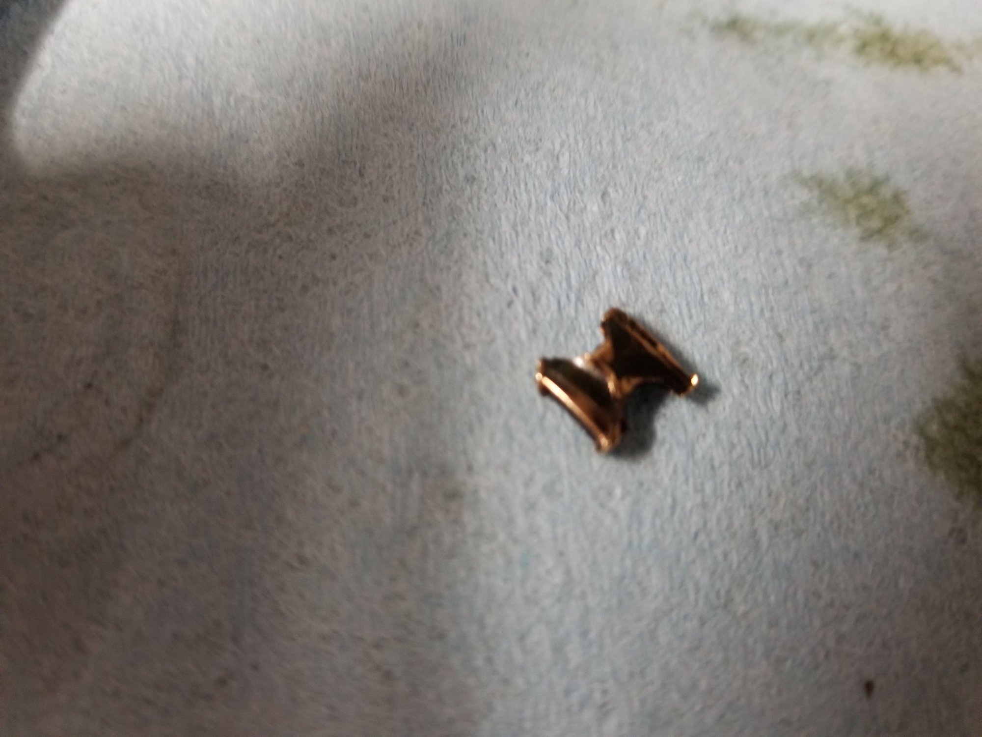

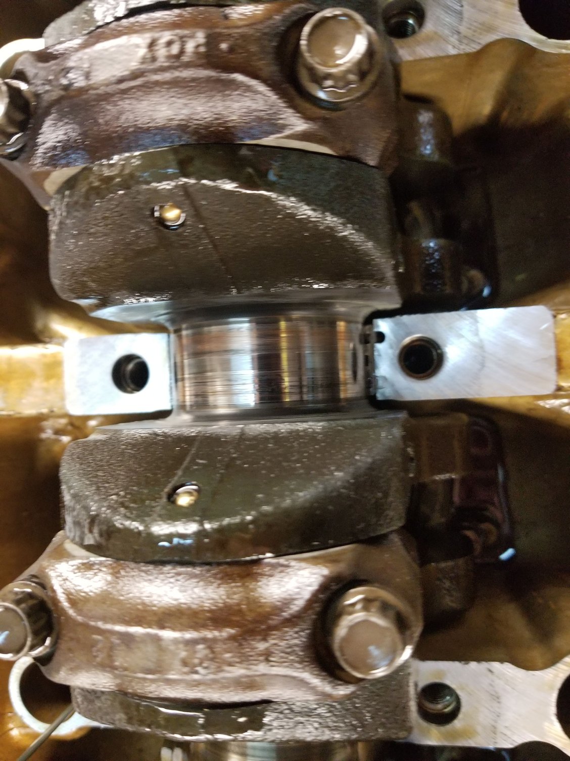

Rod bearings were fine. Pulled the motor and found the center main bearing failed. There was a small piece of what appeared to be a cage to a ball bearing made out of copper. Any idea where this could have come from?
also, does anyone know how much can be taken off the crank journals?

The oil pump may have some caged bearings. Not sure how one would disintegrate. Guess you will find out.

I lost the mains in my engine and the rod bearings were fine. It is opposite of what most people will tell you but it can happen.

My first thought was the oil pump aswell. I took it apart and that doesnt appear to be the culprit.

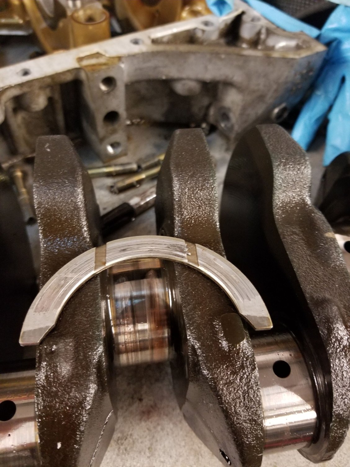

Also, the thrust bearing was showing some wear on the side away from the flywheel...which would be the one getting pressure from the clutch.

Was 110k. I took the crankshaft to the machine shop and they were able to turn it to go once size larger on bearings so all is good

Nothing even close to the size of that piece can get sucked through the oil pump. There is a screen on the base to prevent that, not to mention im pretty sure if that piece did get sucked up it would lock up the oil pump. I do have a relocation kit but I run oem honda filters
