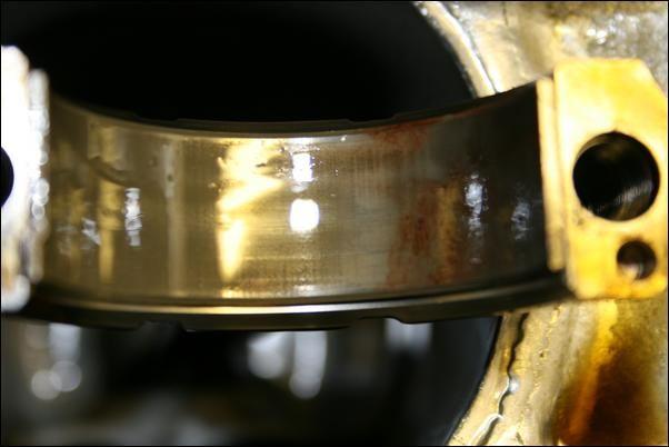

Originally Posted by jonner,Nov 26 2008, 04:09 AM
Are the bearings not usually a copper/goldy colour..???
rods bearings:
main bearings:
