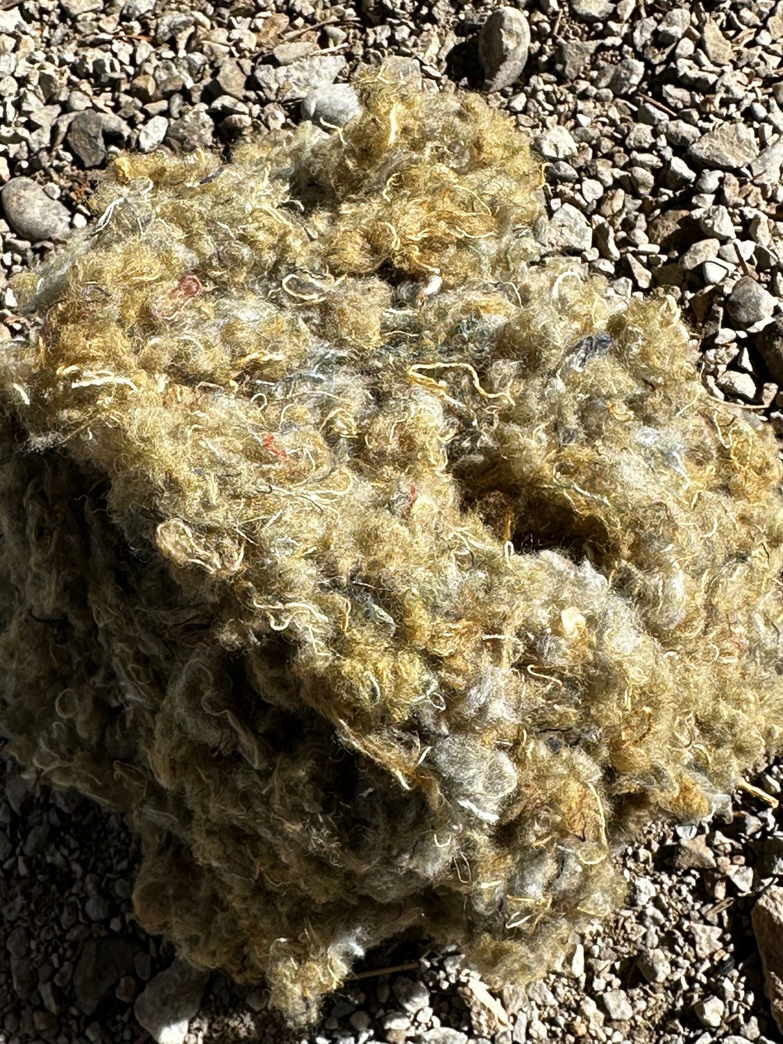

I just got home from a week long trip and found a nest in the trunk when I opened it today. Also heard a bunch of seeds and debris fly out of the passenger footbox blower fan when I turned it on. I've searched a bit for any signs of chewing or where the nesting material was coming from but can't find the source yet. Does anyone recognize this material and its source?

Looks a bit like jute which is the underlayment pad under the carpet inside the passenger compartment. Might be some in the trunk area as well, I'd suggest pulling the trunk panels and having a look.

Yeah that material is used in the truck area along the center bump out next to the spare tire

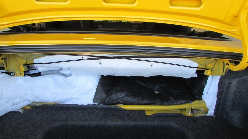

Yes indeed that is the original soundproofing called "jute". Essentially it is recycled threaded material made into mats to help kill sound. It does not work as well as modern materials and absorbs water creating a rust environment, extra weight, smells from mold and other problems. Plus rodents love it.
Modern noise, vibration and harshness NVH materials include hydrophobic materials (3M Thinsulate is used by Honda) as well as vinyl and metal embedded vinyl applied to metal to change resonance and waterproof. Rodents hate it. Rodents do however like to chew on newer "Green" vegan soy based wire insulation. Ask Mercedes how engine wire bundles held up during the 2000-2010 period that were made with that. Nearly a 100% failure rate but I digress.
Rip it out and replace with something better.
