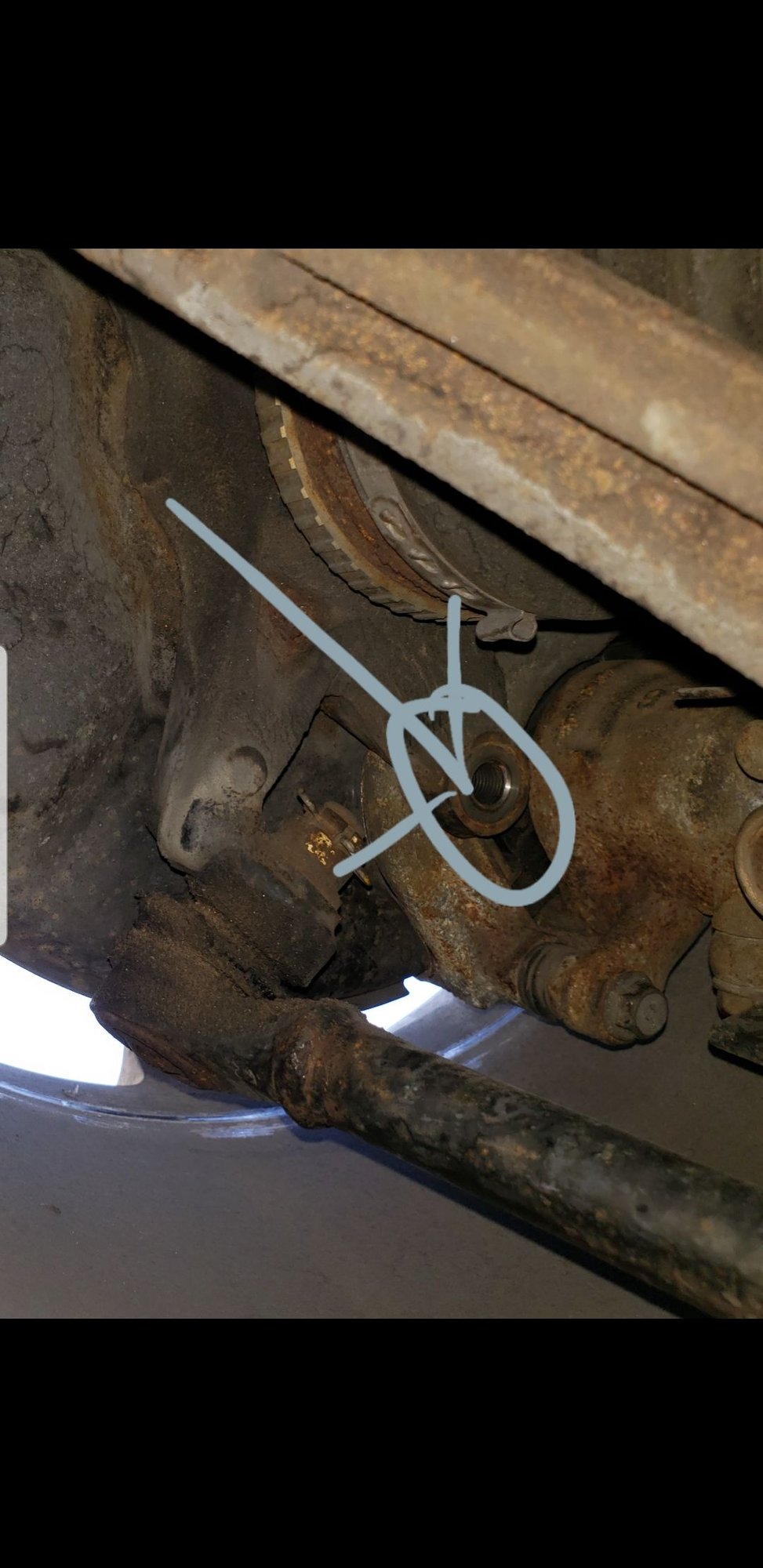

Missing bolt connecting knuckle to caliper bracket.

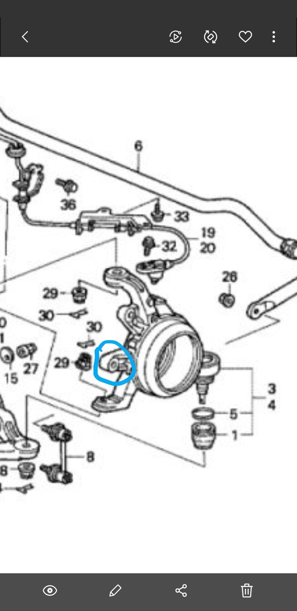

Does anyone know the name/part number of the bolt missing in the picture. I've been looking relentlessly but can't find the exact part.

Its a fine thread M10x30mm flange bolt, here you go: 90103-SV4-013
