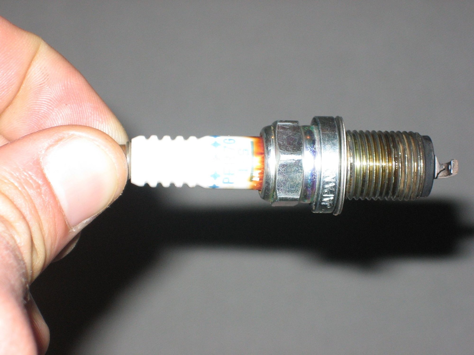

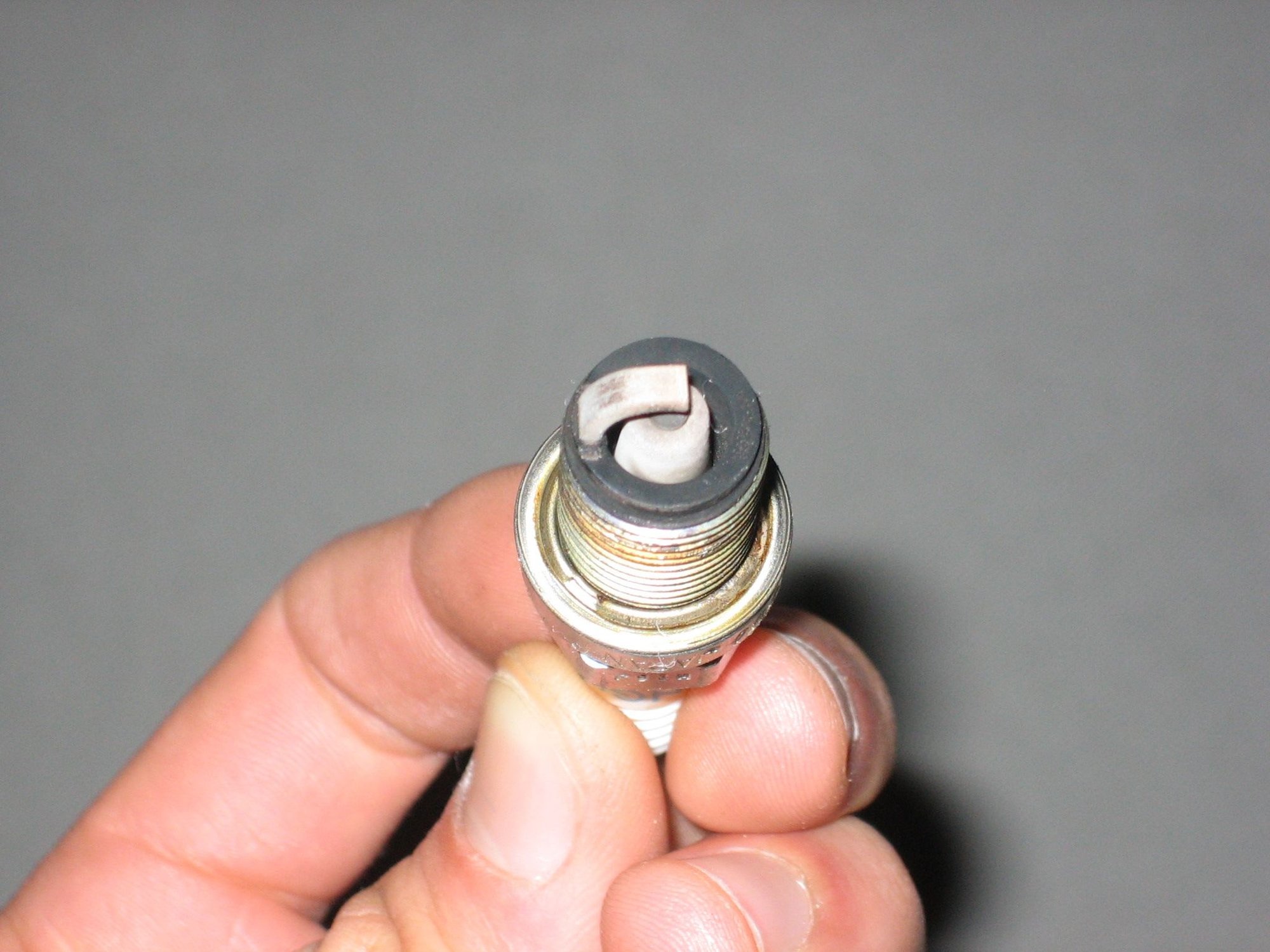

i have 26k miles on the car i decided to check them out, the plugs were not loose in anyway. they look a tad bit lean on first impression but it seems like its normal. Im considering a vafc because people mentioned that our cars run too rich at high RPMs and lean below vtec. tell me what you think about the plugs.PHOTO=312572]

Those look exactly like mine.
some people say its normal, some people think its lean....
Are you running a testpipe with your exhaust, that can lean the car out a bit.

For a NA engine, that looks pretty normal. You can't compare that to a F.I. plug. The NA S2000 can run stoich at idle and little load. No big deal even if it stays over 14.0. But if you are blown, this can't happen.
