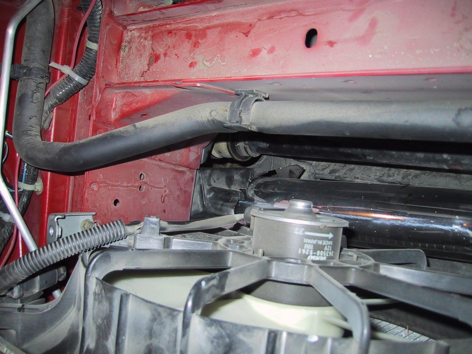

Here are some tips. Remove the rad fan, old airbox and hose and the front bumper. You might need to remove the screws from the other fan too (I had trouble getting it to fit without loosening them). Remove the STB if you have one. I didn't but wish I had.
Installation was easy except for the plastic cutting which took lots of trial and error and a couple of skinned knuckles. Wear gloves for this step or use a dremmel or both.
Hope this helps.
Here is an overview shot of the business end of the install. Yes it's dirty...
Here is a shot of the hoses all connected. You need to remove a metal piping thingy from the stock setup. Note the two joined black hoses under the intake pipe. The kit should have a joiner you use to connect these. It's a coolant hose so expect some spillage. When you disconnect the stock hoses reuse the clips and keep track of what goes where.

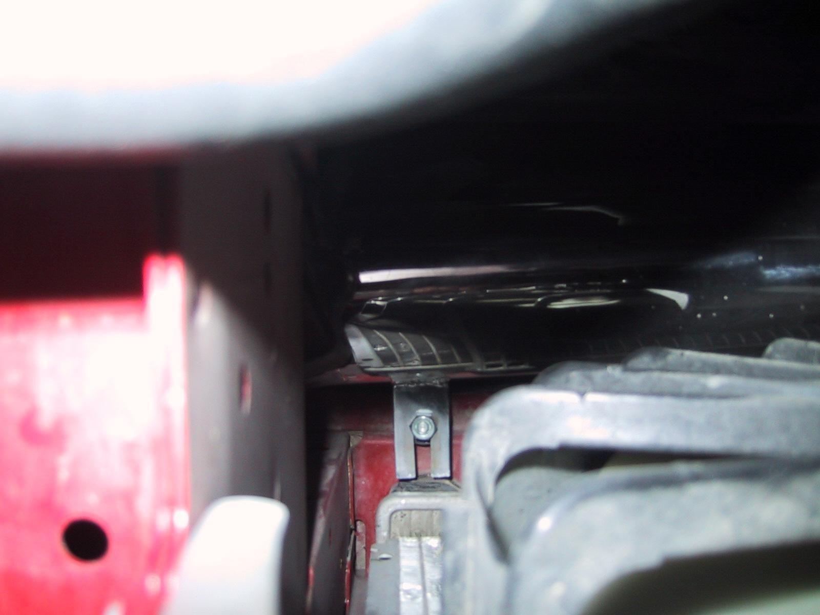

Your kit has a rubber bushing with washers, nuts and threaded rod sticking out of each end. There is a hole in the sheet metal you mount one end to and the other as shown (my kit was missing a nut so I'm using something temporary.
