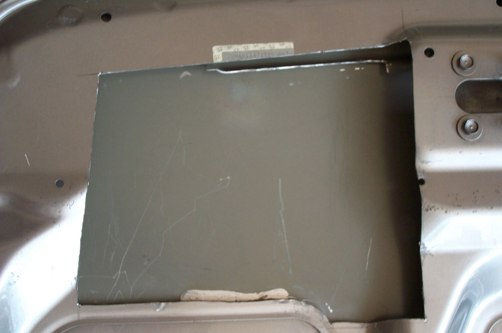

Hi cdelena,
i have no measurements at the hand but i can show you pic of the cut:
Old May 21, 2003 | 06:14 PM
ExOdy's Avatar
Posts: 1,506
From: idbracing
Doesn't look like that bad of a cut.

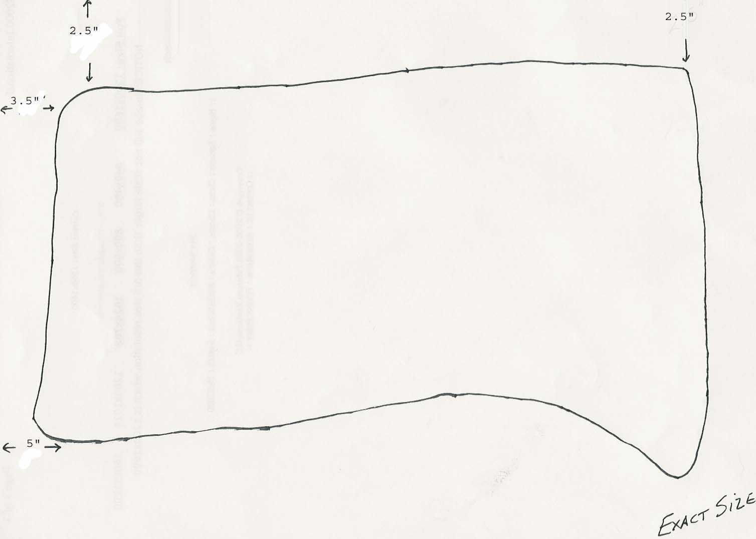

Old May 22, 2003 | 07:18 AM
turbo_pwr's Avatar
Posts: 13,831
From: Paradise Valley, AZ miss NYC
This is on a standard 8.5x11 piece of paper. It is an exact trace from my hood. The measurements are distance away from the edge of the hood.

[QUOTE]Originally posted by turbo_pwr
[B]This is on a standard 8.5x11 piece of paper.
Old May 22, 2003 | 09:55 AM
turbo_pwr's Avatar
Posts: 13,831
[QUOTE]Originally posted by Luder94
[B]
Chris,
I'm not sure about you, but Dan's "trace" is kinda funny (I don't know why, I looked at it and chuckled).

Luis was kind enough to find the measurements and email them to me. So with that and the picture I was able to cut the hood and install the intake this morning.
King did send me the instructions some time ago but there was no chart for the hood cut.
