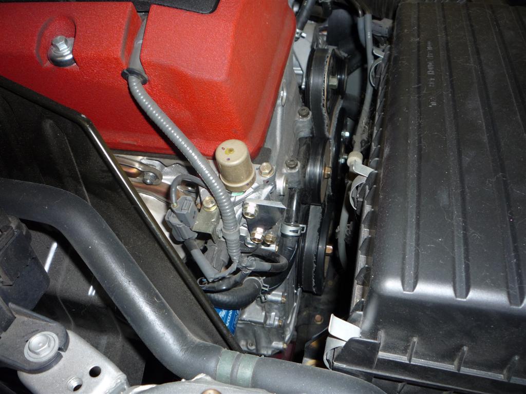

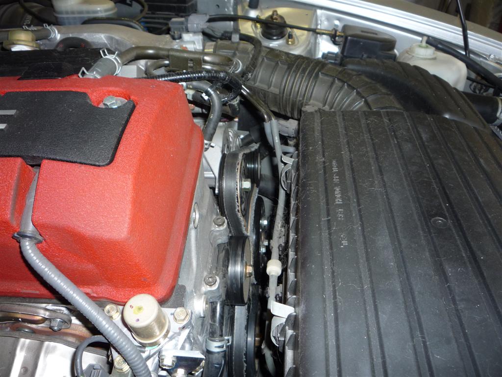

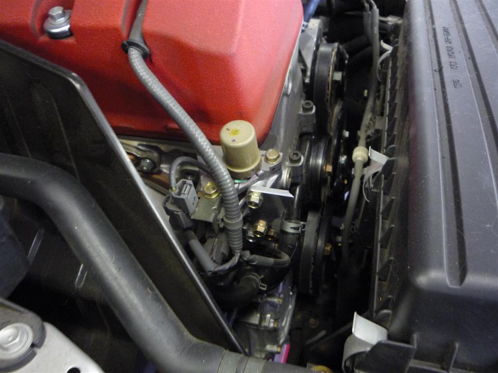

EDIT, here are pics after the the accident before the car was repaired in that area:
