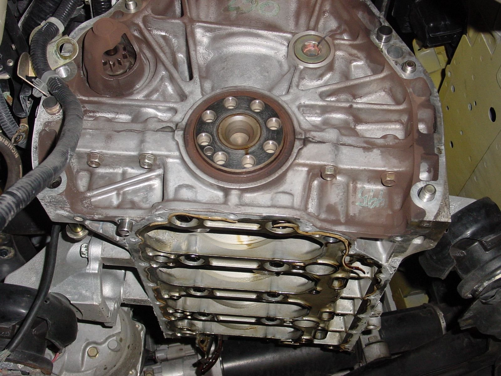

I hope it's the rear main seal...I have found the oil gallery sealing washer squished, causing what APPEARS to be a rear main seal leak. It is near impossible to tell the difference, unless the engine is run with the trans removed.
oil gallery plug and washer is in 1 oclock position from the crank:

Referring to Billman's concern about the oil galley plug and washer I think "replaced sealing bolt on engine block above rear main seal." may be one in the same. OP should be good to go.
