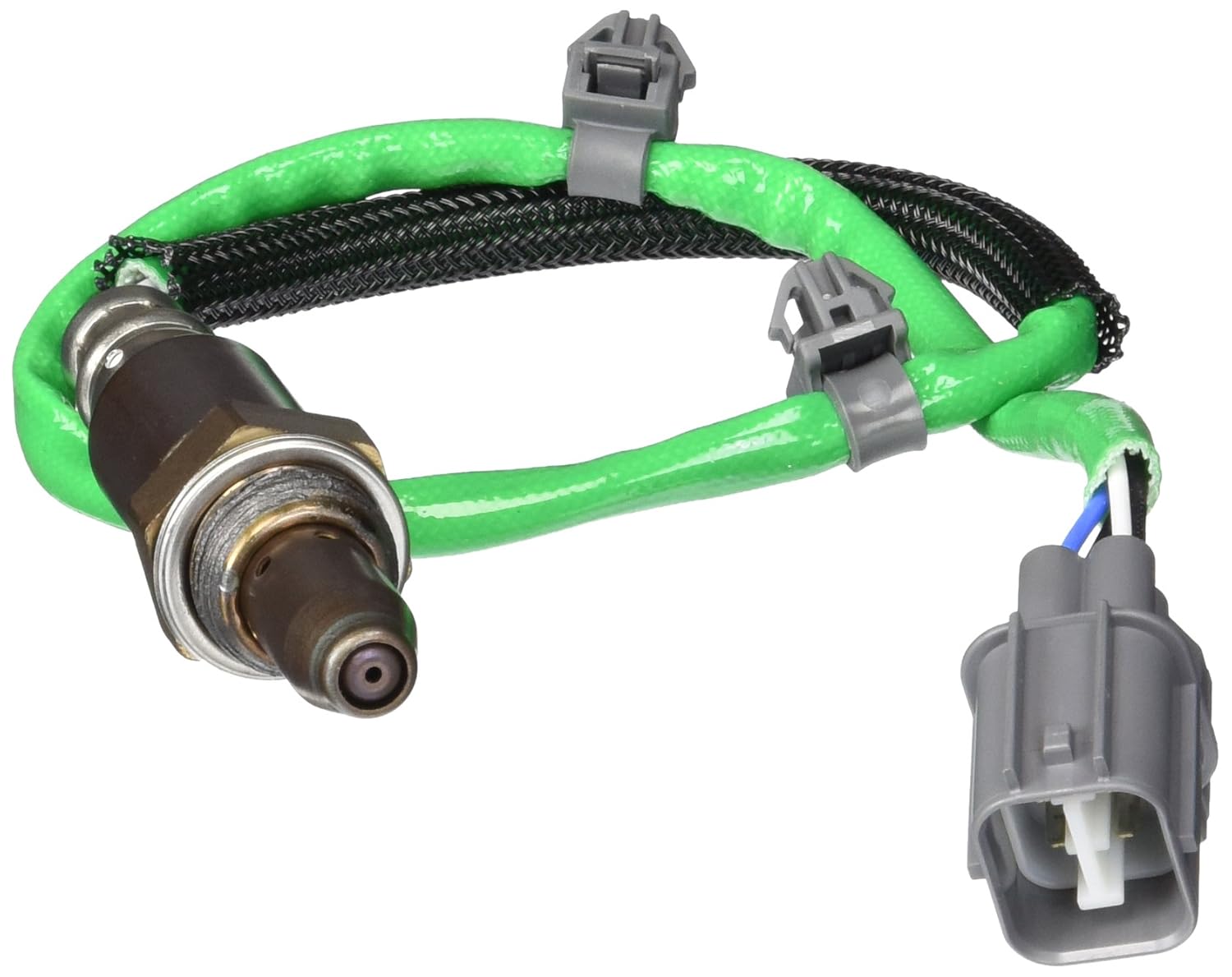

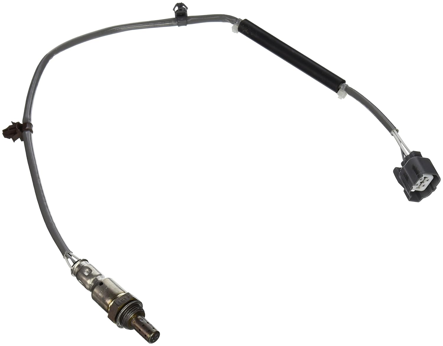

Rear O2 sensor:
http://ecx.images-amazon.com/images/...L._SL1500_.jpg
Front air/fuel ratio sensor:

Thanks for the great photo guide. It is clear mine have been plugged in backwards for some years.
