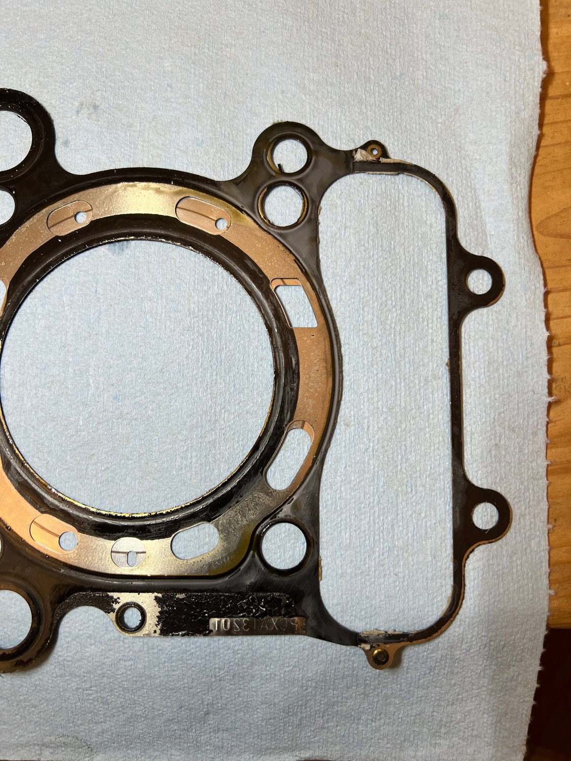

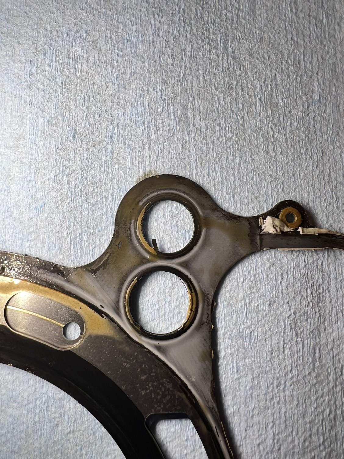

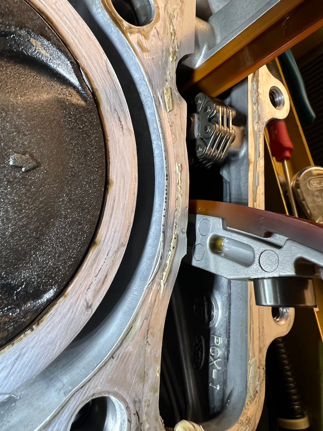

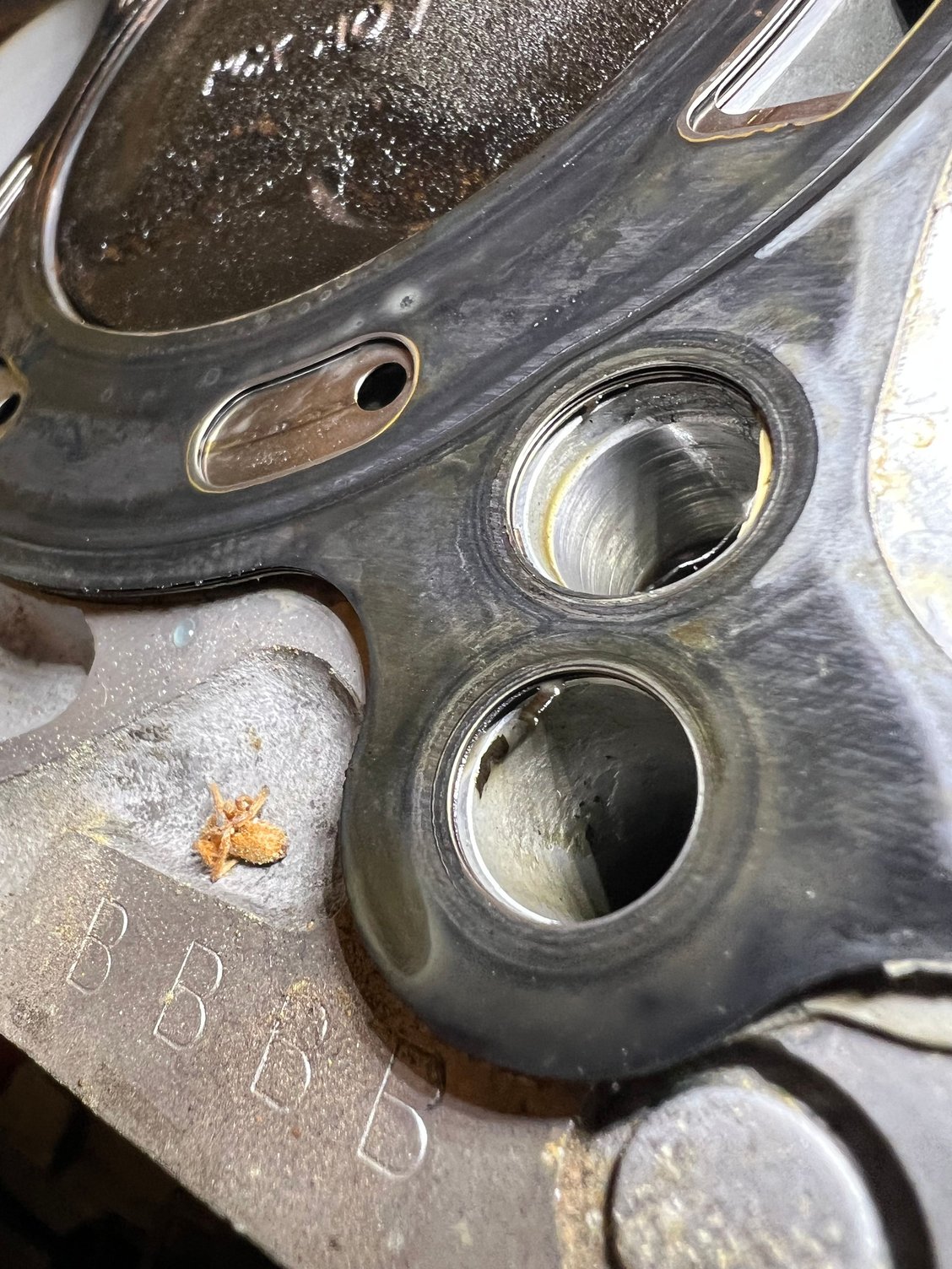

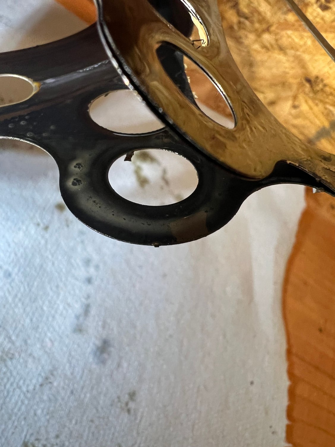

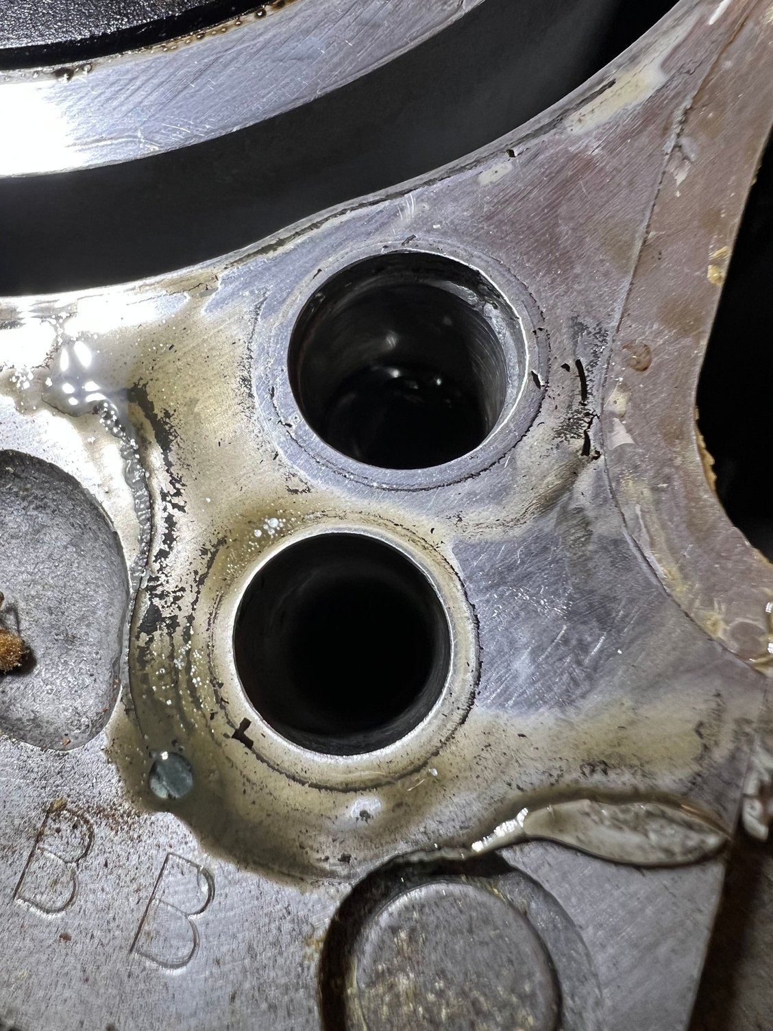

Took off the head today. Judging by the gasket, I highly suspect it's feeding into the coolant from the high-pressure oil feed.
I am surprised to see how much the hondabond has migrated into the head gasket... I understand the assemble calls for a thin line around the chain housing, but the amount of seepage into the head gasket is okay?
I will go ahead and order all the parts.
