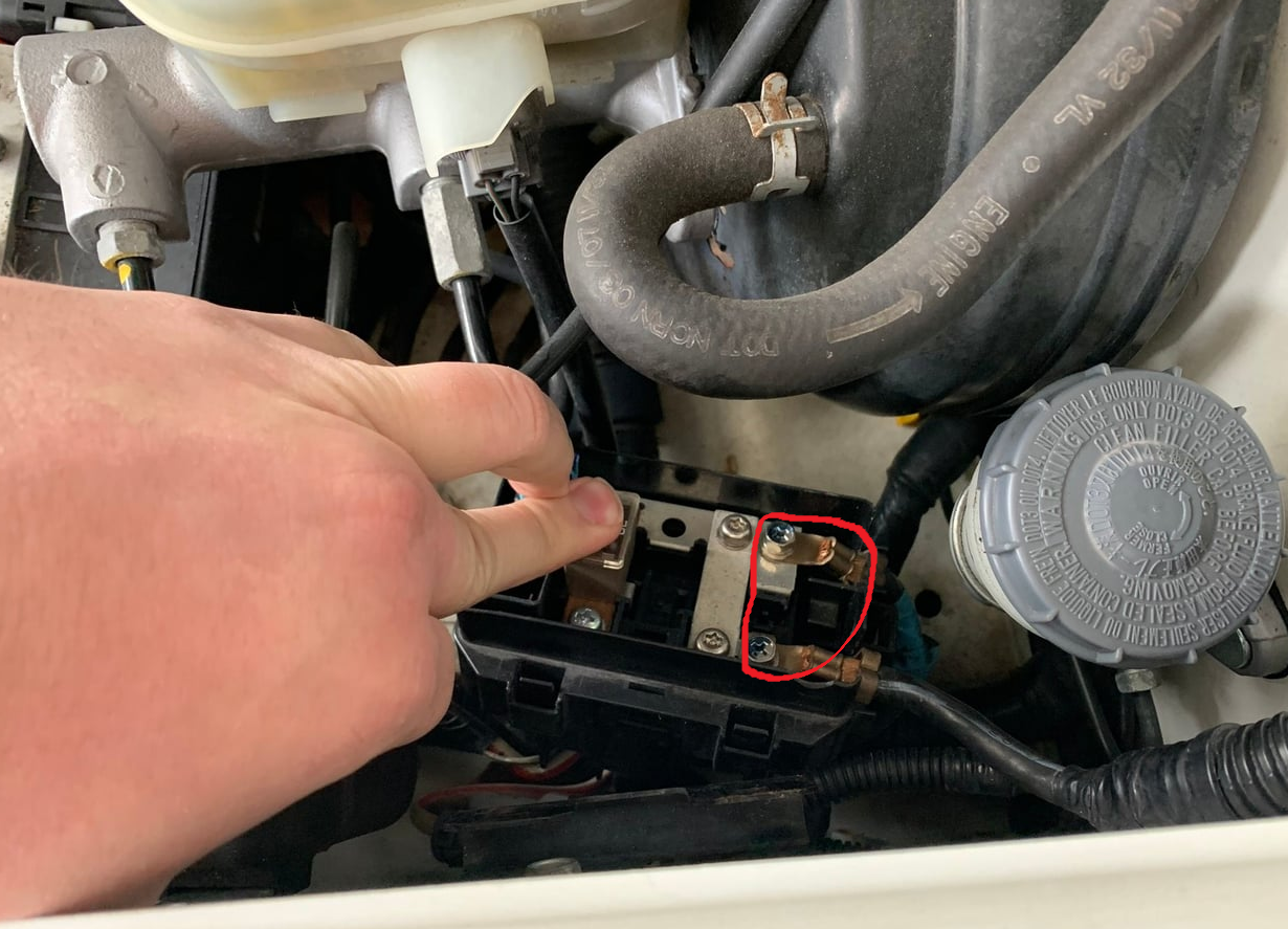

Old Mar 23, 2024 | 01:30 PM
whatisvtec's Avatar
Joined: Sep 2023
Posts: 6
@ES2K , trying to do this and it's a PITA on my 08. When you say remove the fuse box from the harness, do you mean unscrewing the 2 blue bolts in your picture? As circled in red below?
