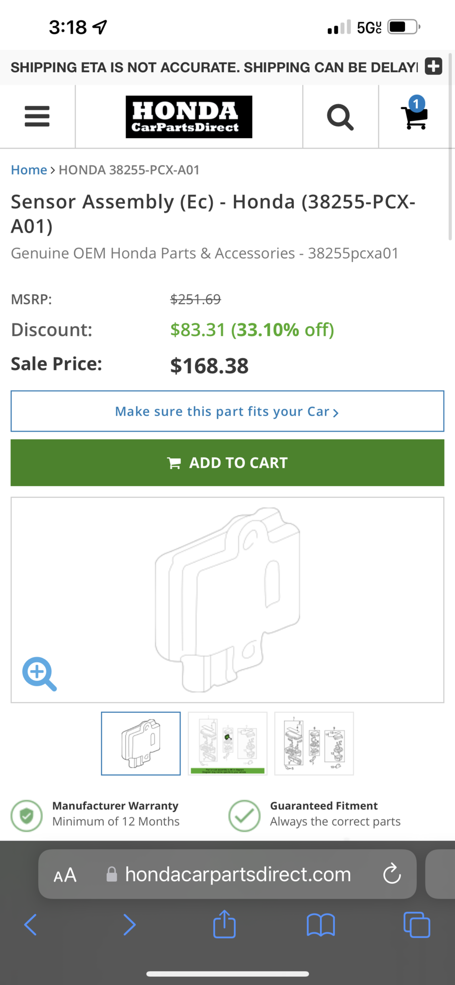

Here’s the ELD sensor alone not the one everyone is seeing from an actual dealership I’ve went up there and talked to them it is bolted onto the fuse box
Here is the ELD sensor and the price for it for everyone who needs it

Thanks. I don't need one but was curious. No bargain!
Says it fits my 2006.
Also says it's not available.
-- Chuck

That ain't the part for the s2k. You can simply look at the drawing to see it's the wrong shape and in a different box.
