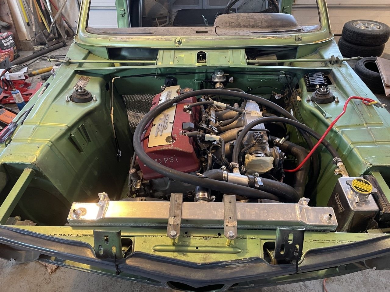

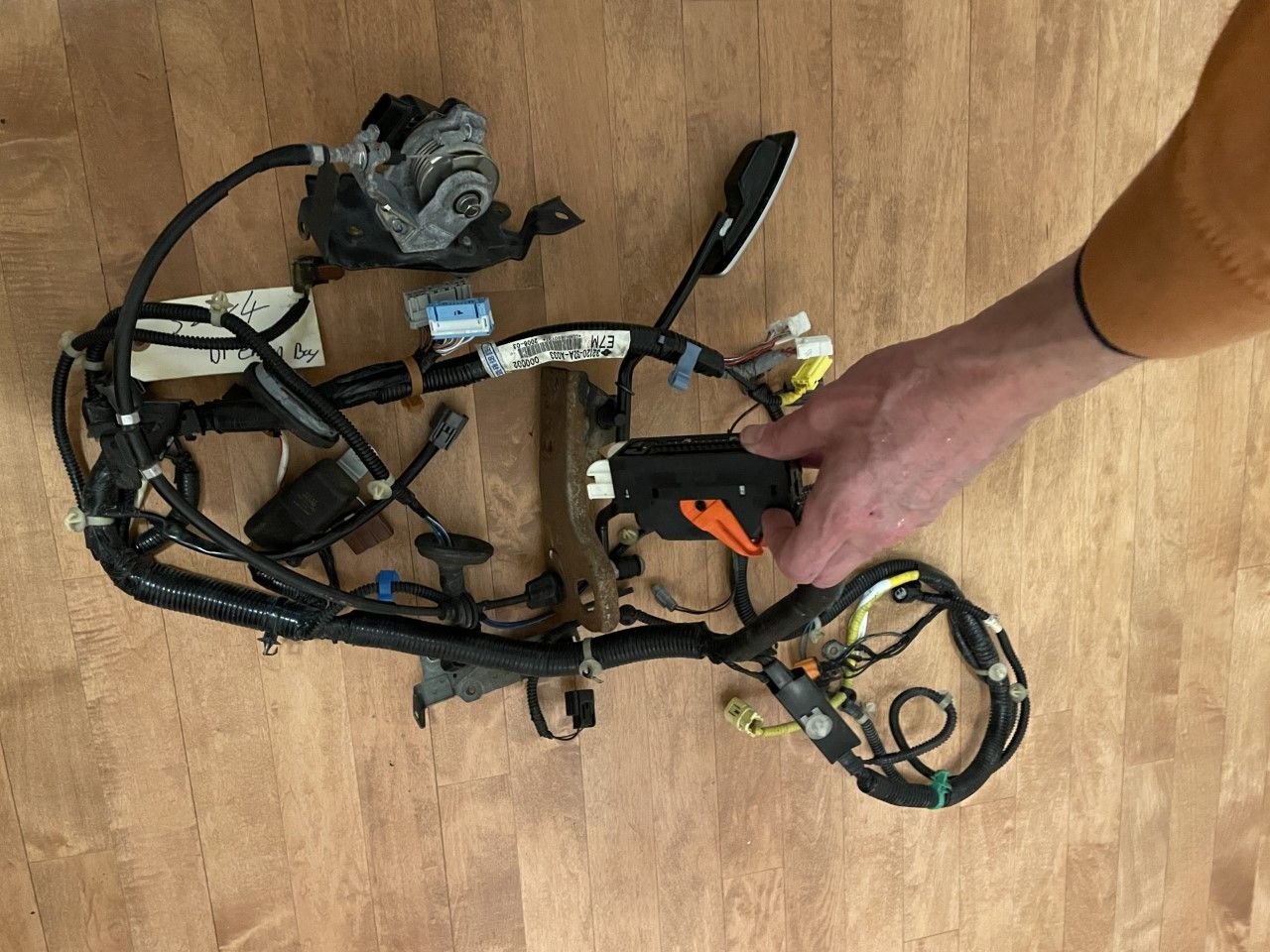

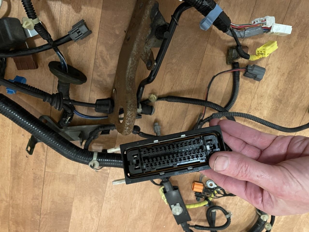

I'm putting an 2007 AP2 into my 1973 BMW model 2002. The motor is mounted and runs but I'm trying to integrate the pedal. I bought a pedal and subharness in the picture but I don't know how to connect it to the ECM and the harness that came attached to the engine. Is there another harness that I need? Does the large connector in my hand (VSA Modulator - Control Unit connector?) connect to something that plugs into the ECM? Thanks for any help you can give me.

I'm wondering if you could adapt the earlier AP1 drive-by-cable setup to your AP2 throttle body? Maybe bypassing all the wiring and ECU?

You will need to look at s2000 workshop manual specific to the 07 in the wiring diagram sections

Thanks, I've been studying the electrical manual but it's beyond my abilities. It goes into great detail of each electrical area but there isn't much of an overview of how everything goes together. From what I've read here, swapping to drive-by-cable is not an easy process. I still have the original BMW M10 engine but it was thrashed when I got the car. Here's where I am so far:

The connector with the orange lever goes to the ABS unit.
