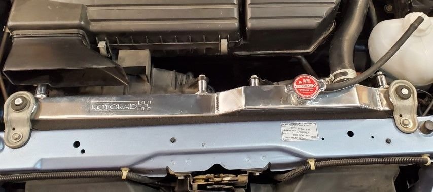

I was conflicted on whether or not to go with Koyo for my AP1 because I wanted to preserve its original look under the hood.
But...the Koyo made total sense. I thought about painting it black. But ended up leaving it in its polished aluminum state. Looks pretty cool even though it maybe looks slightly out of place.

I put a Koyo radiator in recently for peace of mind since it's mostly a track car.
I found this expanding foam weatherstrip at Home Depot that works great to fill the gap in the front.
https://www.homedepot.com/p/M-D-Buil...3115/314012150
