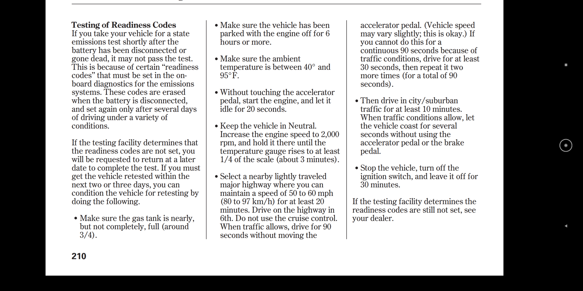

Below is the manual's procedure, which I've followed twice (once before and once after resetting the ECU a couple days ago).

I drove normally (and did the manual's procedure) for a week. Only reason I reset the ECU was because I was doing some other work and thought it might be worth a shot. Even the manual says if that procedure doesn't work there's probably something wrong. I did the procedure plus drove/waited for a whole week before resetting anything.

Yes, I need to get emissions done asap. Aside from that, the manual says if those steps don't fix it, see a dealer, which makes me think it really should be working.
