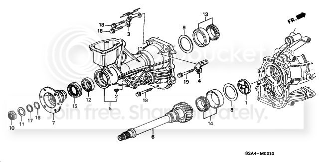

The light of day has clearly revealed my problem:
Old Apr 23, 2013 | 07:21 AM
vtec9's Avatar
Joined: Dec 2005
Posts: 10,106
From: Connecticut
I'd say so.
