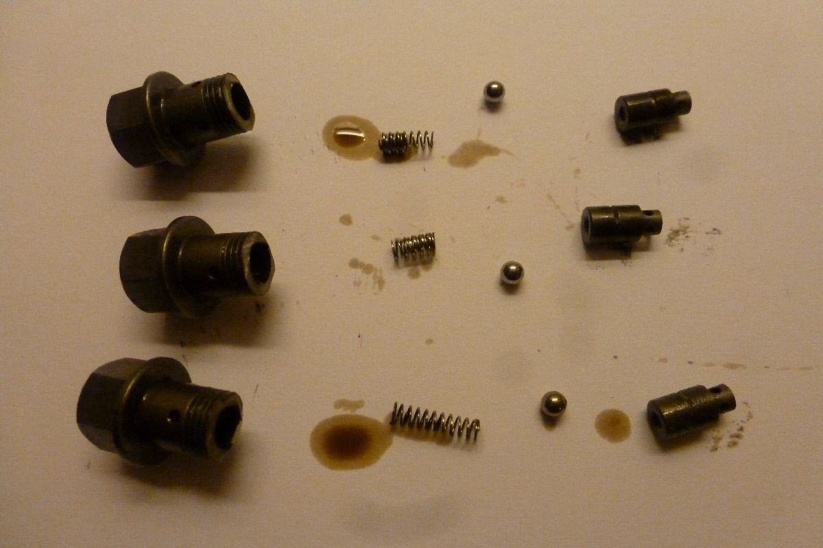

Regarding the replacement of the Nr. 1 Bolt, behind the oil pump, it was not soooo bad while the car was on a lift. With the car on the lift, we had a lot of light and room to position the tool. I think its more diffcult to do with the car on Jack stands...
My theorie regarding the oil pressure light was wrong, i drove the car yesterday. The oil light still has the 1 second delay when starting the engine. Damned.
However,i am convinced that changing the bolts was worth the work and time, because it is good for the engine in the long term.
I found the time and cut open the remaining three bolts. No Surpise, 2 had broken springs, only 1 was O.K.
