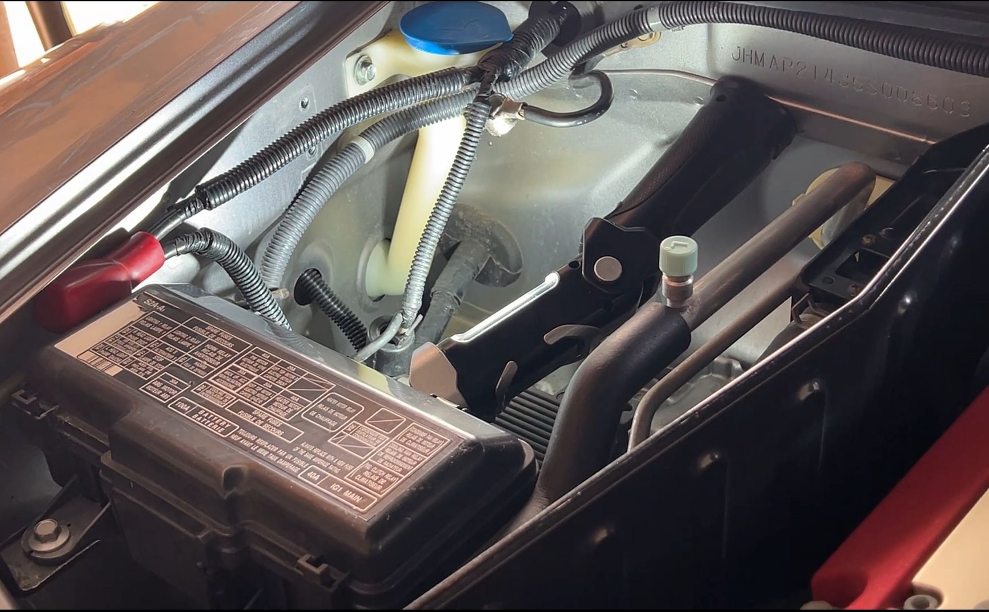

‘05 S2000 - Replaced my 7 yr old battery last month with one from Costco(Wis), $130.
Noticed a bare wire in small wiring harness coming out of interior fender wall next to battery location.
Seems like there should have been a rubber grommet protecting the harness from the sharp edge of the sheet metal hole.
Wrapped it generously with electrical tape and added a new section of flex tubing.
Should there have been a rubber grommet in place here by the factory?
