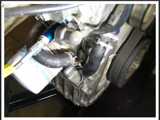

I think a video of demonstration would make everyone at ease especially me since it'll be my first attempt on doing this. Don't want anything to go wrong and waste money on the honda coolant. Was it necessary to remove the engine block drain plug since all my coolant is drain out since I have the new radiator install or is there more that I didn't know about?
