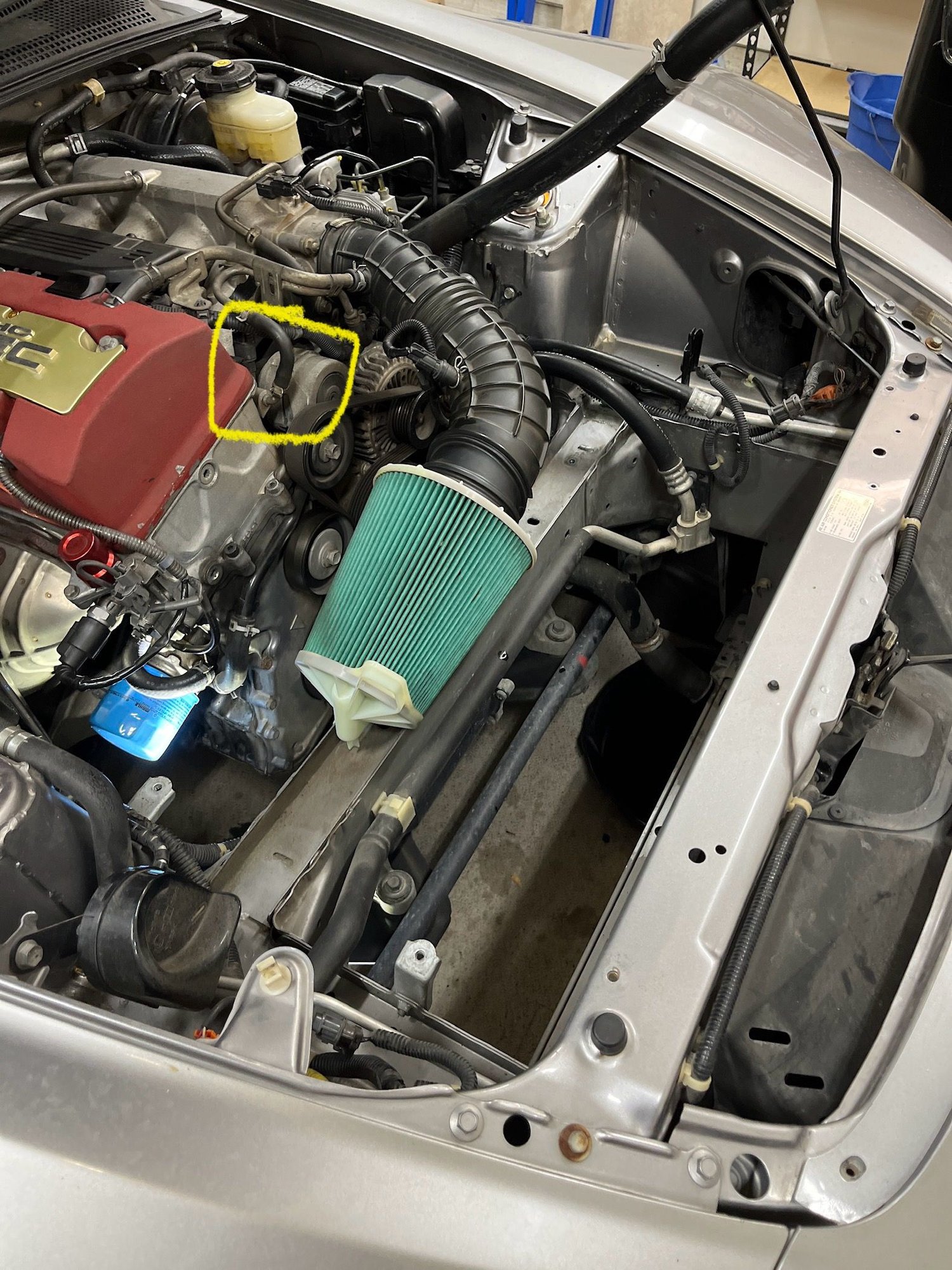

Honda OEM hoses only. I'm planning to replace mine. If nothing else, replace the one under the VTEC solenoid and TCT. It's a small hose, easy to access, and chances are some oil has dripped on it over the years.

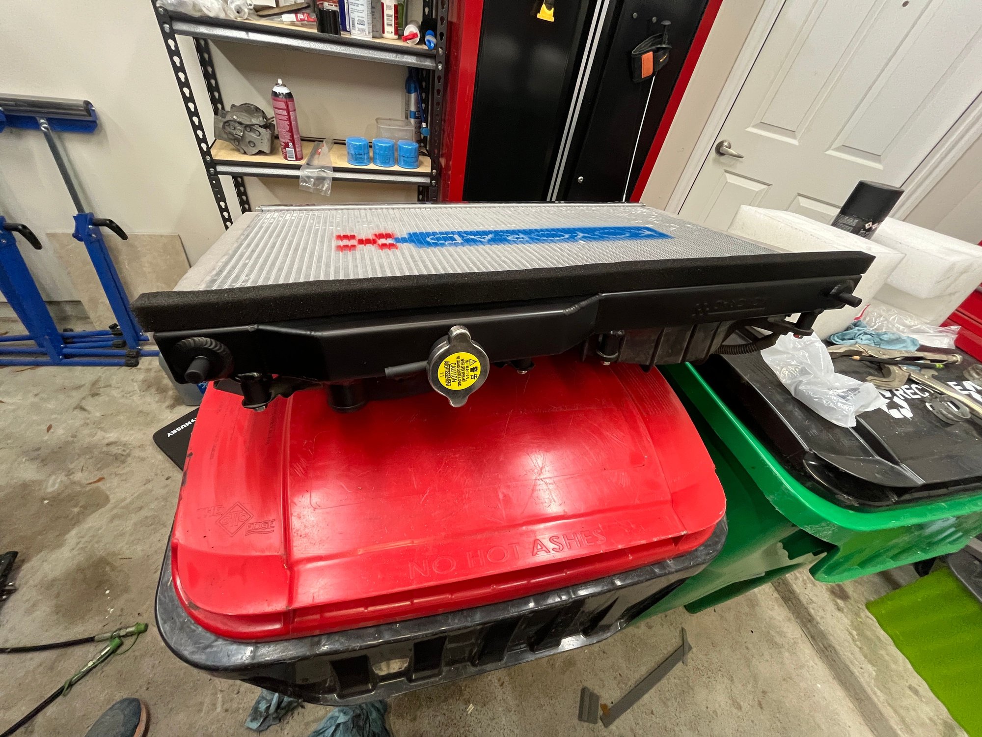

Just finished the upgrade and it was really simple!
The stock was simple to drain and pull with only a few bolts, and the Koyo was a perfect fit replacement.
I did paint the top of the Koyo black with SEM 49143 Trim Black Ultra, and added some foam weatherstripping as well, painted the foam black on the top piece and left it gray on the side pieces.
For my AP2, I had the smaller temp sensor, so I used the supplied adapter from Koyo. I didn’t replace the gasket on the sensor as it was in great shape, but that’s something that I should have purchased anyway. It was hard to tell from the parts online which sensor size I had which is why I didn’t buy it.
I ordered a Mazda 1.1bar radiator cap (to match the factory pressure) from sakebomb and it worked perfect! The part number from Mazda is a couple posts up if you want to get it local.
I used the knock off Lisle funnel from Amazon to fill and burp the system and it worked flawlessly with the car angled up a little bit in the driveway.
The Koyo is so efficient that the radiator fan never kicked on unless I rev’d the engine to 3500 and kept it there for a couple of minutes…and then as soon as I let it idle the fan would turn off again. It’s 70F today in Houston and genuinely after running the car for 30minutes the fan still didn’t come on and I had 8 bars on the temp gauge.
The system has no air bubbles and is blowing 175F at the vents, so I’m super happy.

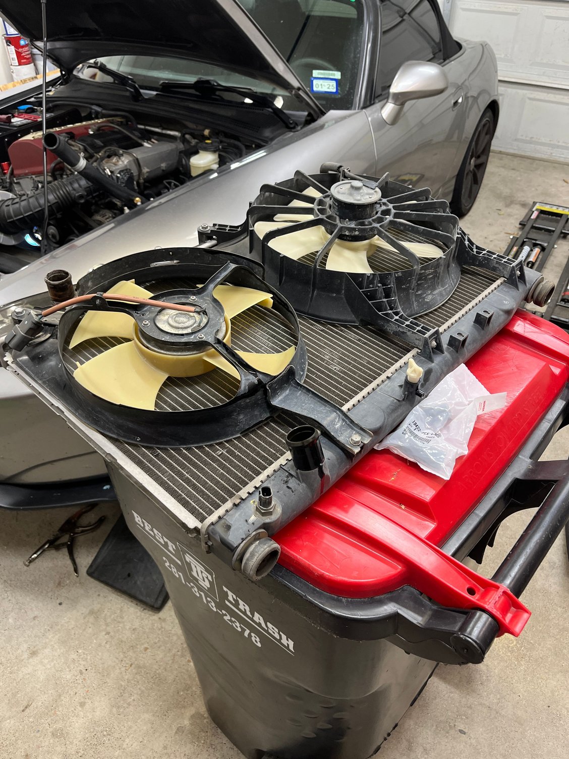

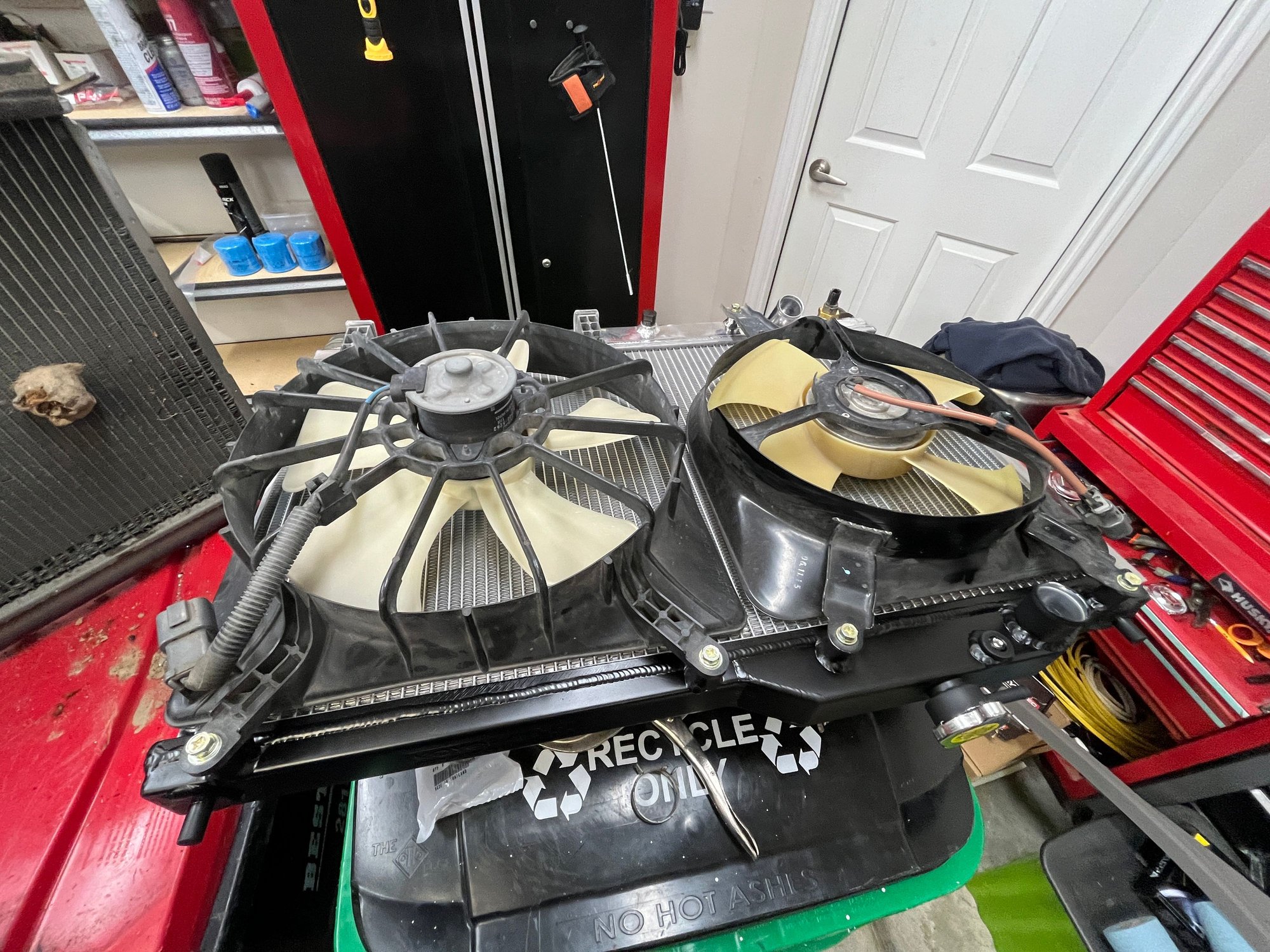

Time to remove the 5 bolts to transfer fans, along with the thermostat and bottom bump stops.
Time to remove the 5 bolts to transfer fans, along with the thermostat and bottom bump stops. Pretty straightforward. The thermostat on the left has an o ring that I would have replaced but it was in good shape. The Koyo includes new hardware for the fans, and a drain plug, as well as a thermostat adapter in case you need it.
The new Koyo, top painted black for a more stock look. You can see the new foam painted black on the top, and the grey foam on the sides.
The new Koyo, top painted black for a more stock look. You can see the new foam painted black with the same paint on the top, and the grey foam on the sides. I used Frost King polyurethane foam air conditioner weather seal kit 99” from Home Depot. It’ll take some trimming to fit, but you can figure it out

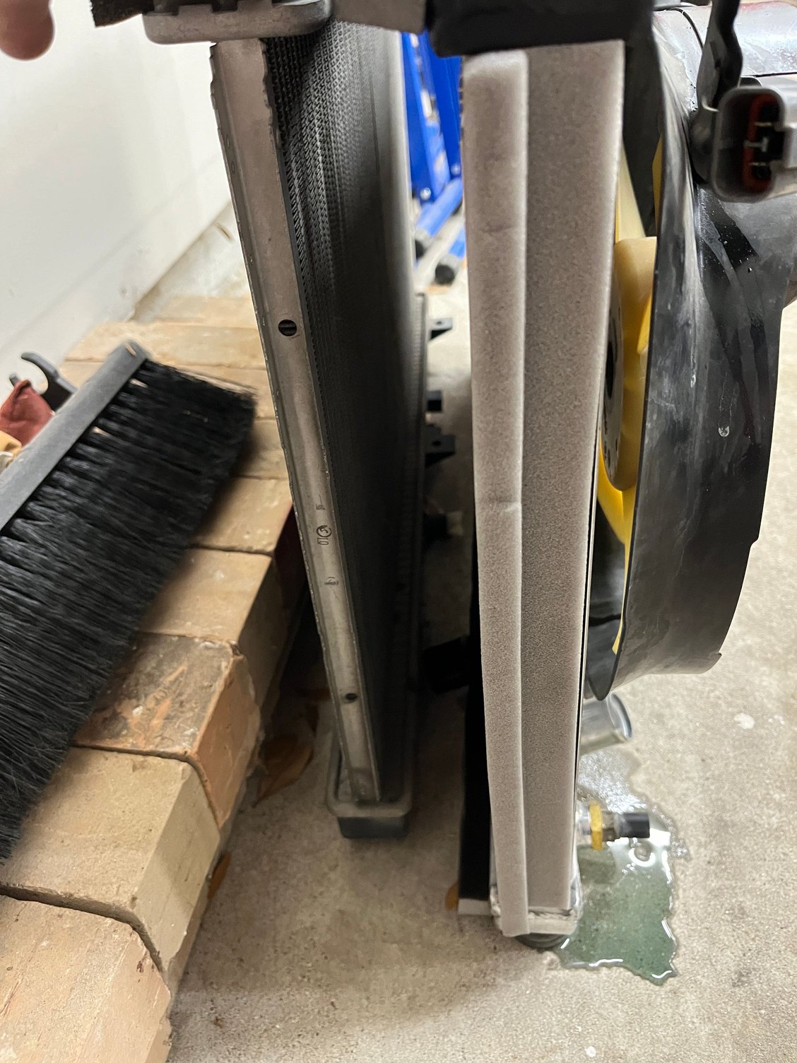

The stock on the left is about half as thick as the Koyo on the right. The foam is blocking the view of the Koyo, but the radiator is the full width of the foam 1.5”.
The new Koyo with everything mounted and ready to go back in.

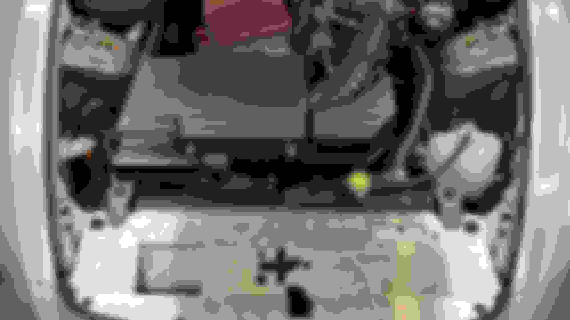

All installed, filled, and burped!  Now ready for some engine cleanup <img src=" class="post_inline_image" data-size="2000x1124" data-src="https://cimg7.ibsrv.net/gimg/www.s2ki.com-vbulletin/2000x1124/1ccb5ee4_85af_42c8_adc8_b6a7b898f409_1e26e11509847b9931dd0270d047578b3030c3e2.jpeg" loading="lazy" />
