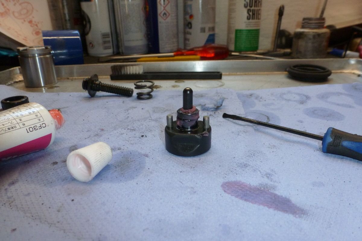

How could i remove part Nr. 15 ? It sits thight inside the brake caliper body and just moves barely (Propably hold in Place by the O-Ring). Tried to remove it gently with long nosed pliers, no chanche..

Watched some Youtube video. Nr. 15 is really hold in Place only with the O-ring, but it sits thight. Best way is to tap the whole brake caliper on the Workbench until it falls out. Will see....
This is really not a work for beginners, and not fun. Next time i will try to get overhauled brake calipers. My ambition to do maintanance on the car by myself has found its limit here.

I tried it, but no luck. My pliers sliped.
BUT: There is a tiny hole inside part 15. Secure the e-brake lever with a clamp, use a air gun with a long nozzle and just blow with compressed air into the hole. And "Pop".. its out.
I figured out how to re-assemble part 15 with the "pill" (part 14) in 30 seconds. I will post my solution with pictures this week.

Here is my way:
- Fit the E-brake lever with spring, so that the lever is hold in Postion.
- Place the Caliper in a vise (or vice), upwards and straight
- "Glue" part 14 to 15 with brake caliper grease
- Use a magnetic hand and carefull place part 15 from above into the caliper. Done. I have done it two times, it worked perfect. Fits at the first try in seconds. No hassle, no swearing.
