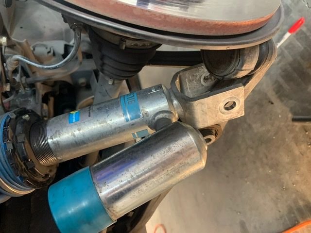

I’m installing some new DFVs and running into an issue I can’t get the rear struts out. I’ve taken the top bolts off, the endlinks, and the lower strut bolt, but there is so much pressure from the LCA that I cannot get the strut to clear. Has anyone had to disconnect the LCA or know what might be causing this? I’ve scoured multiple DIY guides and none have had this issue.

Any idea what would be causing so much tension from the LCA?
This is what the passenger side is like at the moment. The driver side still had the lower bolt attached but it is loose. The reason I haven’t removed it is I can feel the pressure from the LCA, making it difficult to move the bolt out. On the passenger side I actually had to use a hammer and punch.

Its the resistance from the rubber bushings. You must loosen all the control arm bolts to free things up.
This should clearly illustrate why you need to clock the bushings when you are done with the install. The bushings only have so much total travel. You want to make sure that travel is centered at the new ride height. That is what clocking bushings does.
Car on stands, level. Loosen ALL upper and lower CA bushing bolts (except for the front compliance bushing), AND the lower shock mount. AND the toe arms. Anything with a bushing.
Now jack up under one control arm, until it just barely lifts off the jack stand, unweighting that stand, stimulating that corner being at ride height suspended by the tire.
Now torque down all the bushing bolts at that corner. Be super careful. Do not place yourself under the car, as its now teetering on a jack. Repeat for each corner.
Failure to do this correctly results in odd ride heights and eventually torn bushings.

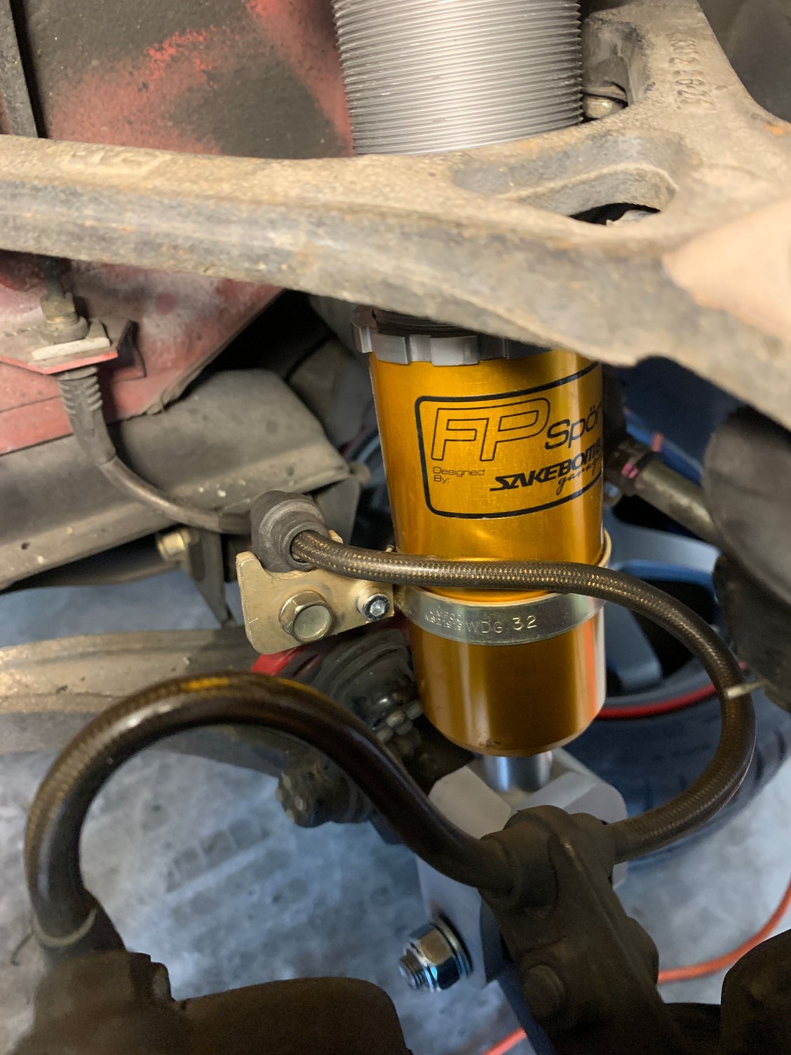

As an aside, I forgot to take a picture of the brake line routing before i took out the old struts. Are they supposed to route behind or in front of the struts? I had them behind so there would be no rubbing on the strut housing, but it seemed like it was stretching out the cable a bit so I tried routing it in front. Now though, it looks like it might wear out in time with enough abrasion. Anyone recall which way is correct?

They should be routed in front of the struts, it looks incorrect in your picture.

Won't hurt nothin. Well I take it back, the bracket on the shock for the brake line looks dangerously close to the sway bar end link.
