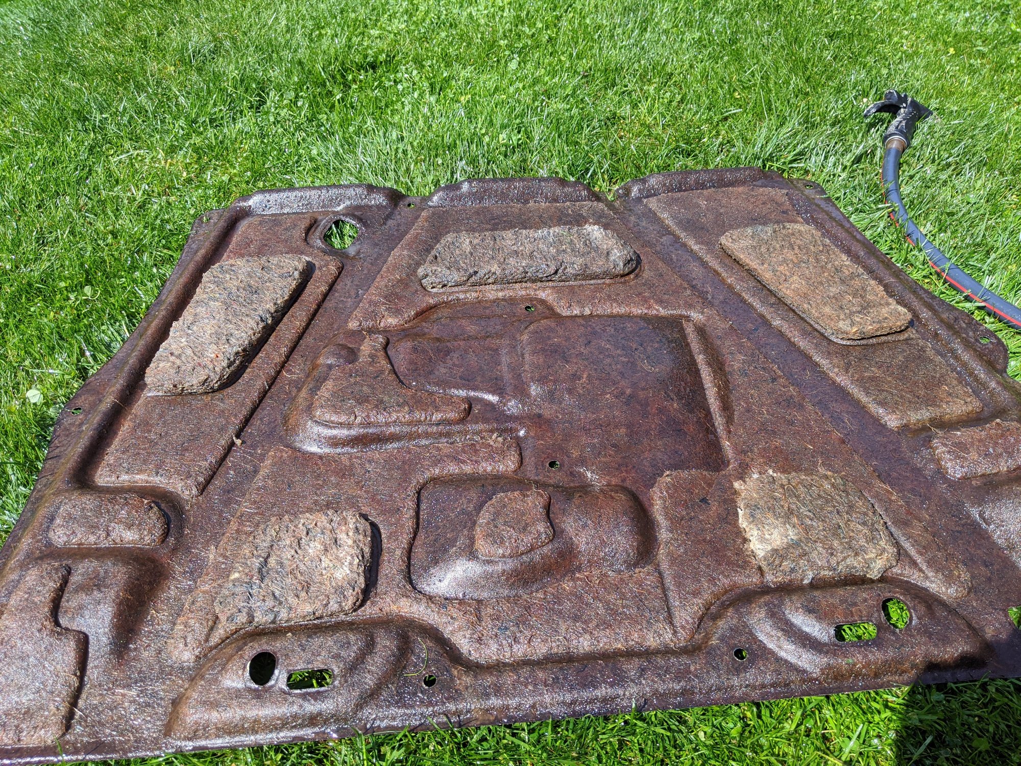

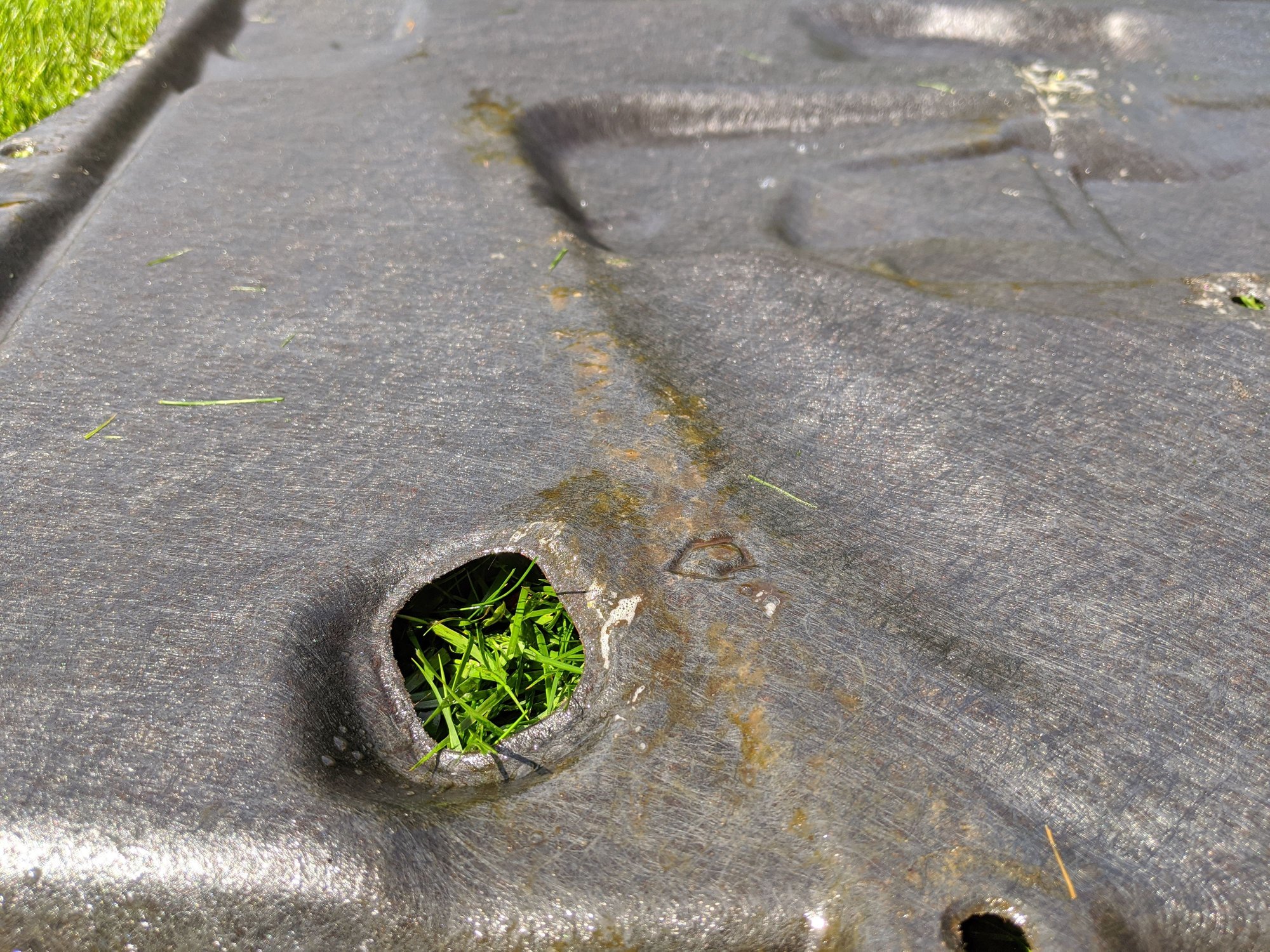

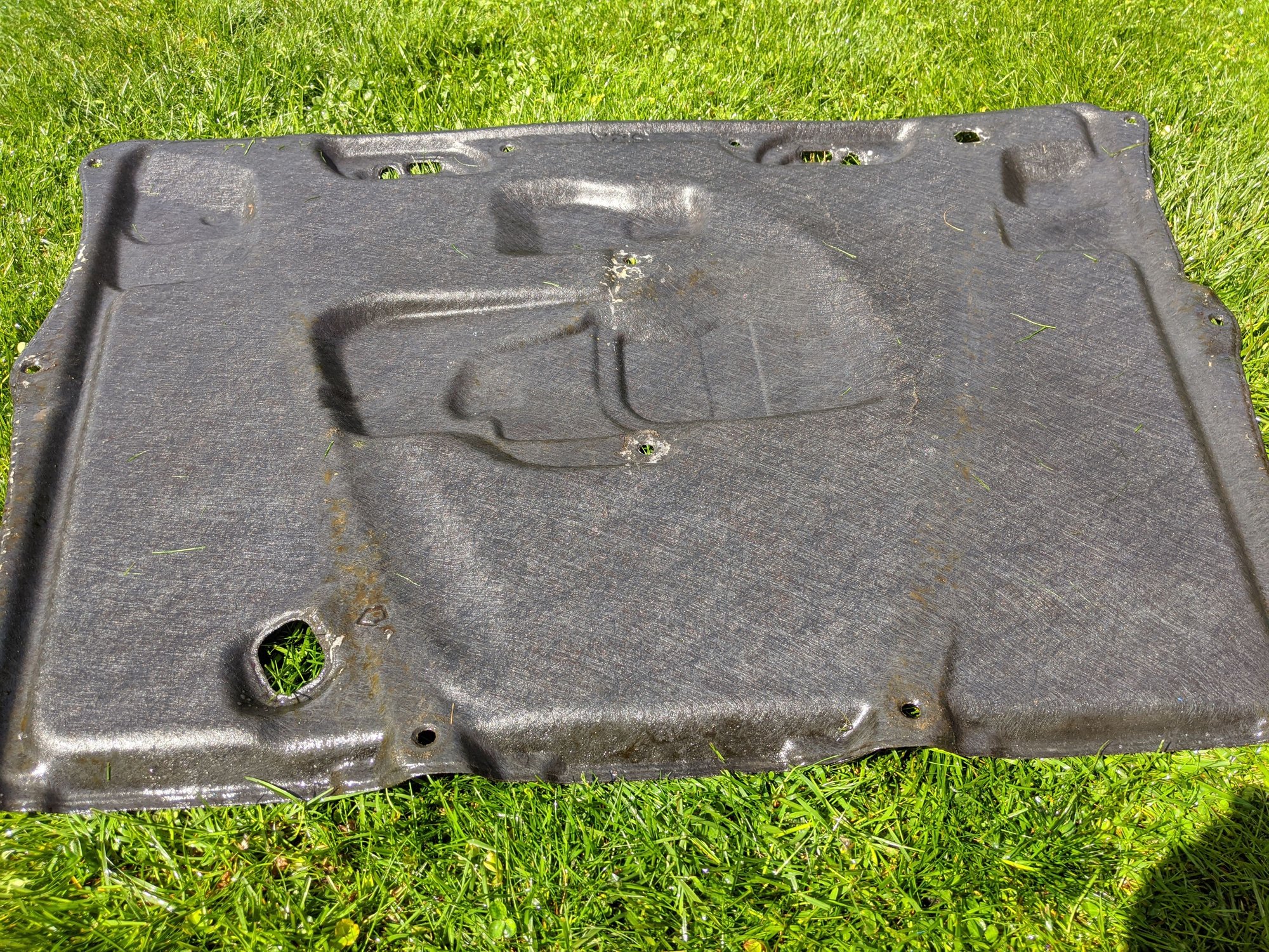

I don't think this is going to be salvageable. Good news is this is definitely the source of my hot day oil stench. Bad news is it won't come clean. The oil just moves from the side I am cleaning to the other side and back again. It also didn't seem to like being soaked with water as the padding on the back started to come off and the insulation was cracking in a couple places.
I ended up buying trim removal tools from harbor freight and gently prying off the clips. I also needed to unhook my windshield washer fluid hoses. Otherwise it came off easily. probably could have re used the clips as they were minimally deformed.
​​​​photos of the cleaning attempt in progress:
