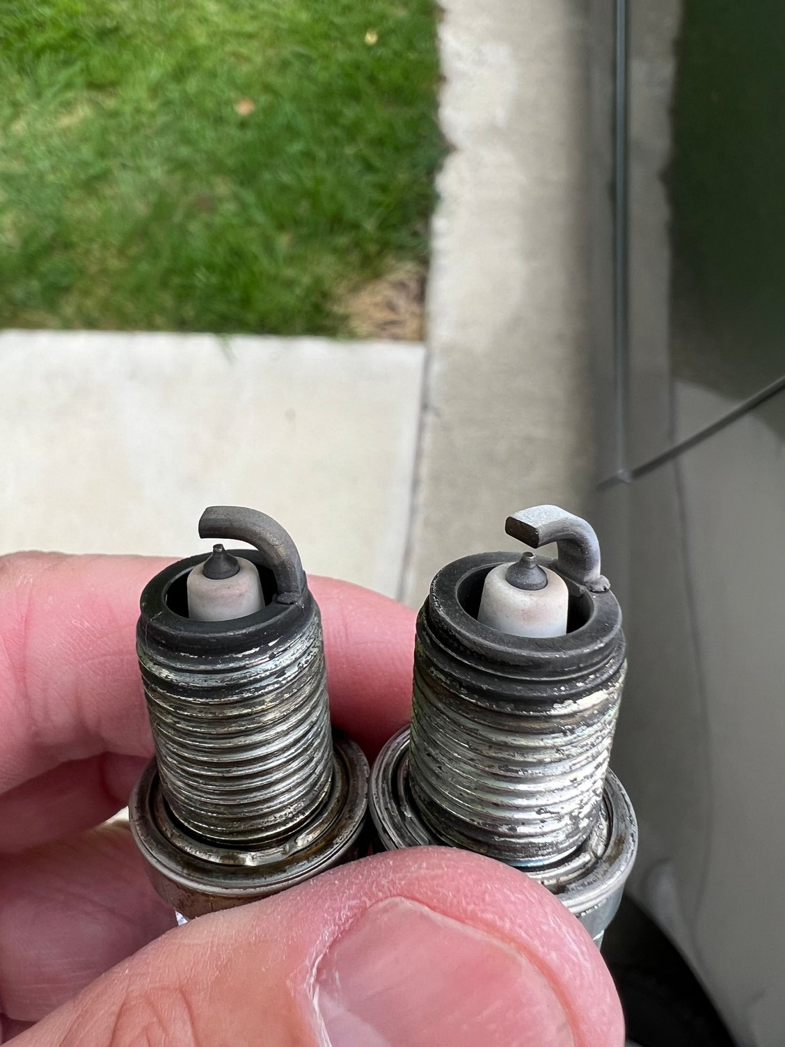

if it helps here’s my spark plugs from cylinder 1 and 2.

Plug on the right looks like it's running a little leaner than the one on the left. Could just be the lighting, the whiter the ash, the hotter/leaner it's running
